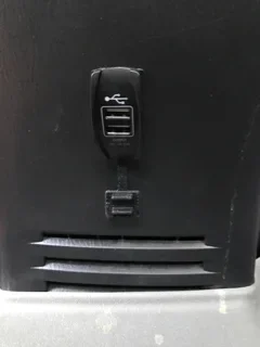

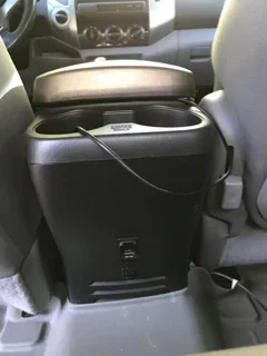

What I did to mine. The fuse box that's under the dash left side under the steering wheel. There is a constant power fuse. When you look at the fuse box it's the top right fuse. Hit it with the voltage meter first see if it has power with the truck off. ImageUploadedByTaco Forum1493638843.430297.jpg if you have one of these in the picture makes it look a lot cleaner when it comes to splicing it.
What I did to mine. The fuse box that's under the dash left side under the steering wheel. There is a constant power fuse. When you look at the fuse box it's the top right fuse. Hit it with the voltage meter first see if it has power with the truck off. View attachment 11426 if you have one of these in the picture makes it look a lot cleaner when it comes to splicing it.
This is what I want to do, vice dismantling everything. Can you give me the specs on that?
