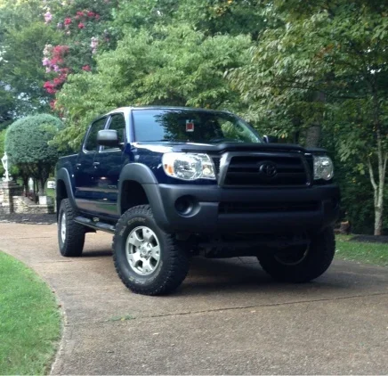

Yes, oh could just get the front shocks and level the truck, but if you wana do some real wheeling and fit 33s then I suggest getting the whole set up. I think it comes out to just under 400 bucks for all four shocks and the rear AAl.
Yeah 1.75 is level, as for the tires you can fit, I don't think you could fit 33s, I think you would still have to run stock size or maybe 32s not sure
Would 5100s all around and aal in the rear be enough for a nonTRD SR5 or would front springs need to be upgraded as well?
Any idea on parts and average install cost? Or is it something that could be done by someone mildly mechanically inclined?
I did it all my self. I'm only 16 but I know a lot for my age. Price for the shocks and AAl plus shipping was a total of just under 400 bucks. It's pretty simple to do. I would say the hardest part was the AAl. If you don't know how to do it you could look it up on YouTube
Well I got all four shocks plus the rear 2in AAl from wheelers, so it lifted the whole truck, I'm far from a professional but I have done a couple lifts on trucks so it took me about 4 hours if I remember right
