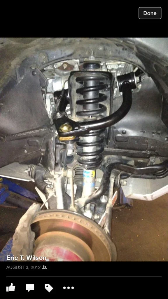

The spacer between the shock and mount makes the shock bottom out before you hit the bump stop. The spacer just above the coil makes the ride harsh since the stock coils aren't meant to be preloaded more which is a problem with the 5100s and stock coils. Why would you want to bottom out the shock early or make your ride worse?
This setup works awesomely! Bilstein 5100's OME 886 heaviest because of bumper, winch, two batteries! Light racing UCA's! I put 188,000 miles with all kinds of wheeling on this set up!ImageUploadedByTaco Forum1420421223.980662.jpg
Sold the FJ , setup was in it! Building a 2007 Taco double cab now!
