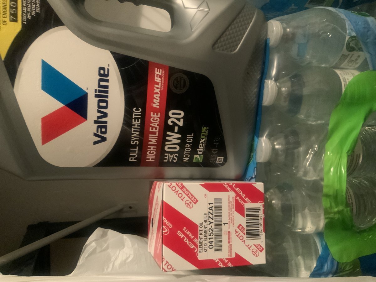

Greetings everyone! I have a 21 Toyota Tacoma TRD 4x4 sport. Let me preface this by saying this is the first Toyota I've owned with the rest being Hondas. I've heard that when changing the filter, it is better if the cap housing is made of metal. Could someone please link the correct part for the V-6 engine, since I cannot post a link?
In addition, what oil filter and oil brand is recommended for its next oil change?

The aluminum cap that I bought is a dorman part number 917-016 or 917-016cd. The only difference is the cd comes mounted in a card to hang for display and the other one comes in a box. I know Advance Auto and Auto Zone has them and you can also get them from Amazon. Some prefer stock OEM oil filters but I use either Purolator Boss or Amsoil oil filters. As far as oil, the factory oil is a version of mobil1, I use either Pennzoil or Amsoil, however pretty much any me brand oil with an SN or SP rating will do you just fine. I'm not convinced the 1 year 10k mile oil changes that Toyota recommends is the way to go, I change mine at 6 months, 5/6k miles.
