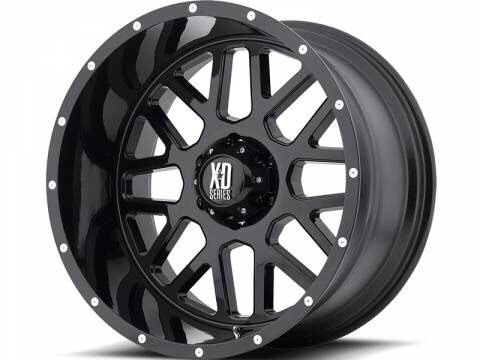

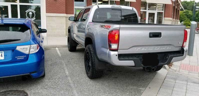

Yeah is not going to be right now is just some im thinking of View attachment 19068
