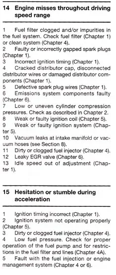

I have a 1996 taco 4wd with the 2.7. it died the other day, the fuse to the fuel pump went out, I went ahead and replaced the fuel pump and now it idels fine but when put under a load it misses terribly ?? please help

#1 on the list is clogged fuel filter.
When was the last time you changed it?
Location of fuel filter below.
Okay , Fuel pump, Fuel filter , and pressure regulator replaced. Still the same problem!!! I am at a loss??? on this any help would be greatly appreciated.
Hum ok well I'm going to be lazy and just scan what the manual says.
Oh and this is from the Haynes Repair Manual Tacoma, 4Runner & T100, Tacoma '95~'04, 4Runner '96~'02, T100 '93~98 All 2wd & 4wd models.
