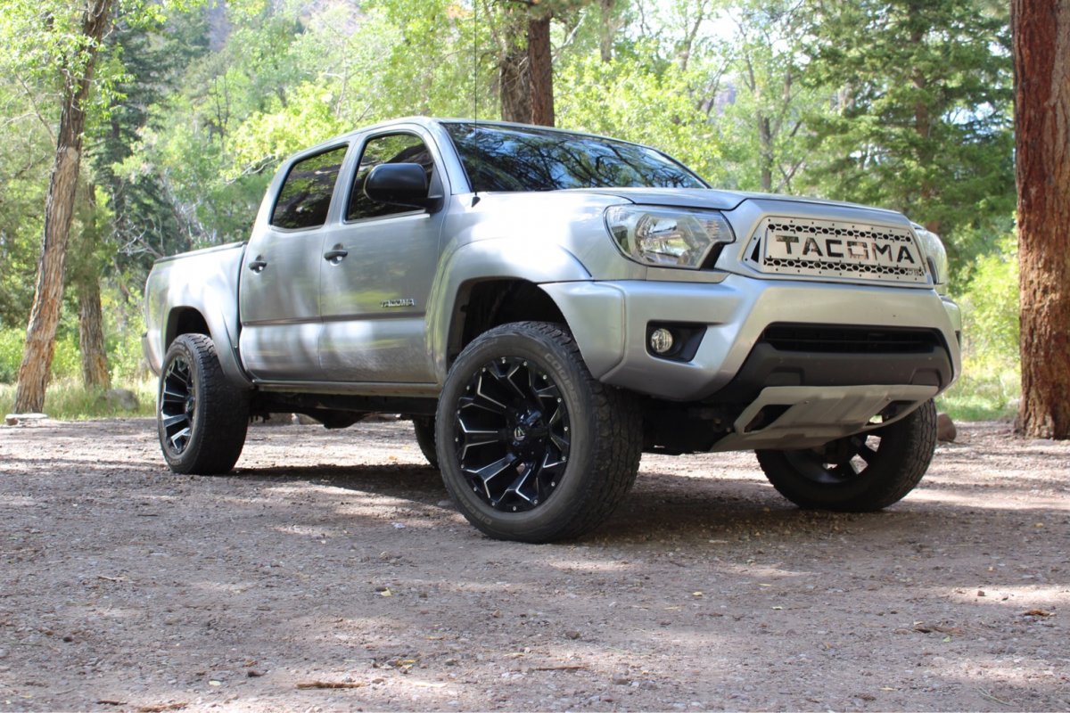

Whats the biggest size of tires I could run with my leveling kit 3” in front 1” in back

What size tires are on it and are you wanting to keep the same wheels or get smaller wheels and bigger tires?Tacoma 2014 wheels I have now are fuel assaults 20x12 -24 offset
I’m not sure how to get the image I posted to load it says I can’t view it.
Will post again.
33 x 12.5 -20 is a fairly common size and you'll probably rub a little but that's the biggest you'll want. 305/55R20 is a close metric size. With a 12" wide wheel you'll need to stay wide but don't want to go taller than 33".View attachment 21678

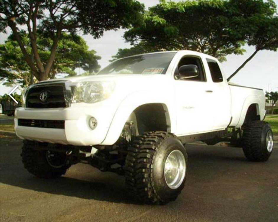

It will rub haha33 x 12.5 -20 is a fairly common size and you'll probably rub a little but that's the biggest you'll want. 305/55R20 is a close metric size. With a 12" wide wheel you'll need to stay wide but don't want to go taller than 33".
