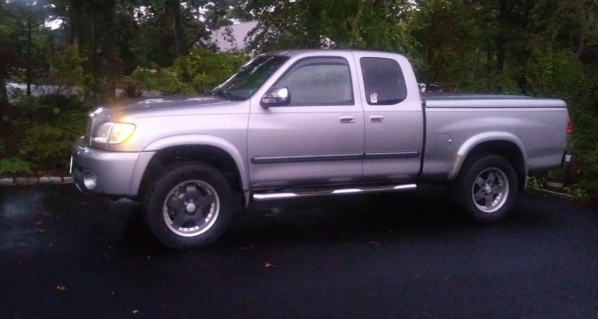

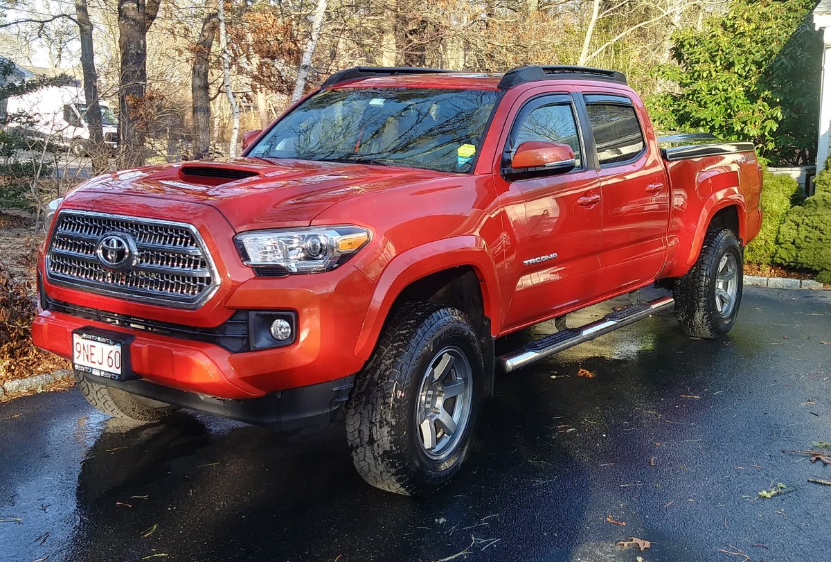

That looks really fun ! When i first got my taco, i still had my 03 tundra and for shats and giggles it put my 18 x8.5 Moda wheels on it with 285-60-18 kuhmos and 4.5 backspace with 0 offset did not rub at all .i should have swapped them but i would have had to put 1.5 spacers on the tundra cuz the wheels tucked in to far .My bad .i think they were 32 tall and 11.5 wide .they looked sweet on it .but i put 17x9 with 265-70-17 and they rubbed -12 offset 4.5 back space .I dont quite get the whole offset thing isnt that kinda like backspace? View attachment 32047

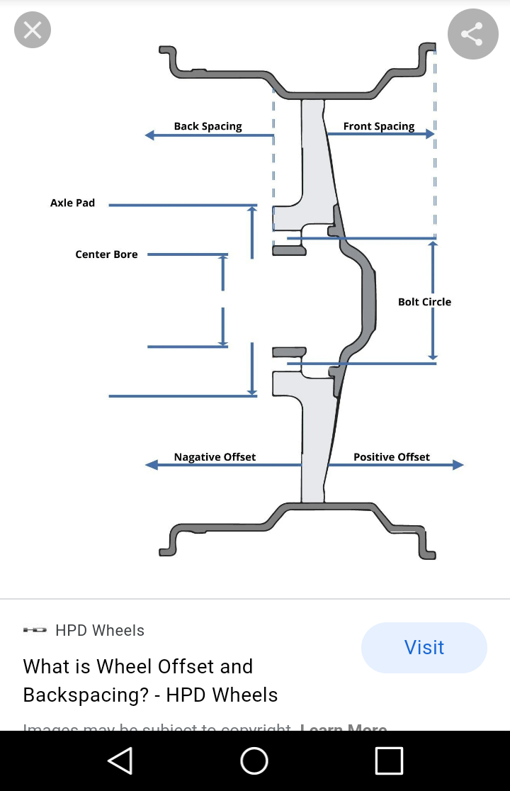

Backspace and offset are different from each other but one can be used to find the other. It’s a formula I don’t have handy. But using both is the best way to find wheels that make life easier when going to bigger tires [emoji16].
IIRC
Offset is used to measure how far the mounting portion of the wheel is from the center of the wheel, I.E. a 0 offset is perfectly distanced on either side.
Backspacing is simply how much space from the back of the wheel.
I could have mucked that up though. I’ll find an article later to confirm.
