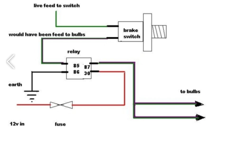

Here's a very simple wiring diagram of brake lights, not specific to an 03 tacoma but hopefully this helps. So again, I'll ask, was there power coming into the switch on the pedal? (Separate power source) (find a good grounding point for negative lead, touch positive lead to either terminal on the switch, should get 12v?) Is your meter set to the correct setting? 20180923_082037.jpeg
I'm not getting any voltage out of the plug on the brake light switch. I've rechecked the fuses again. I have no choice but to take it to a shop. I've done all I could. Thanks.
