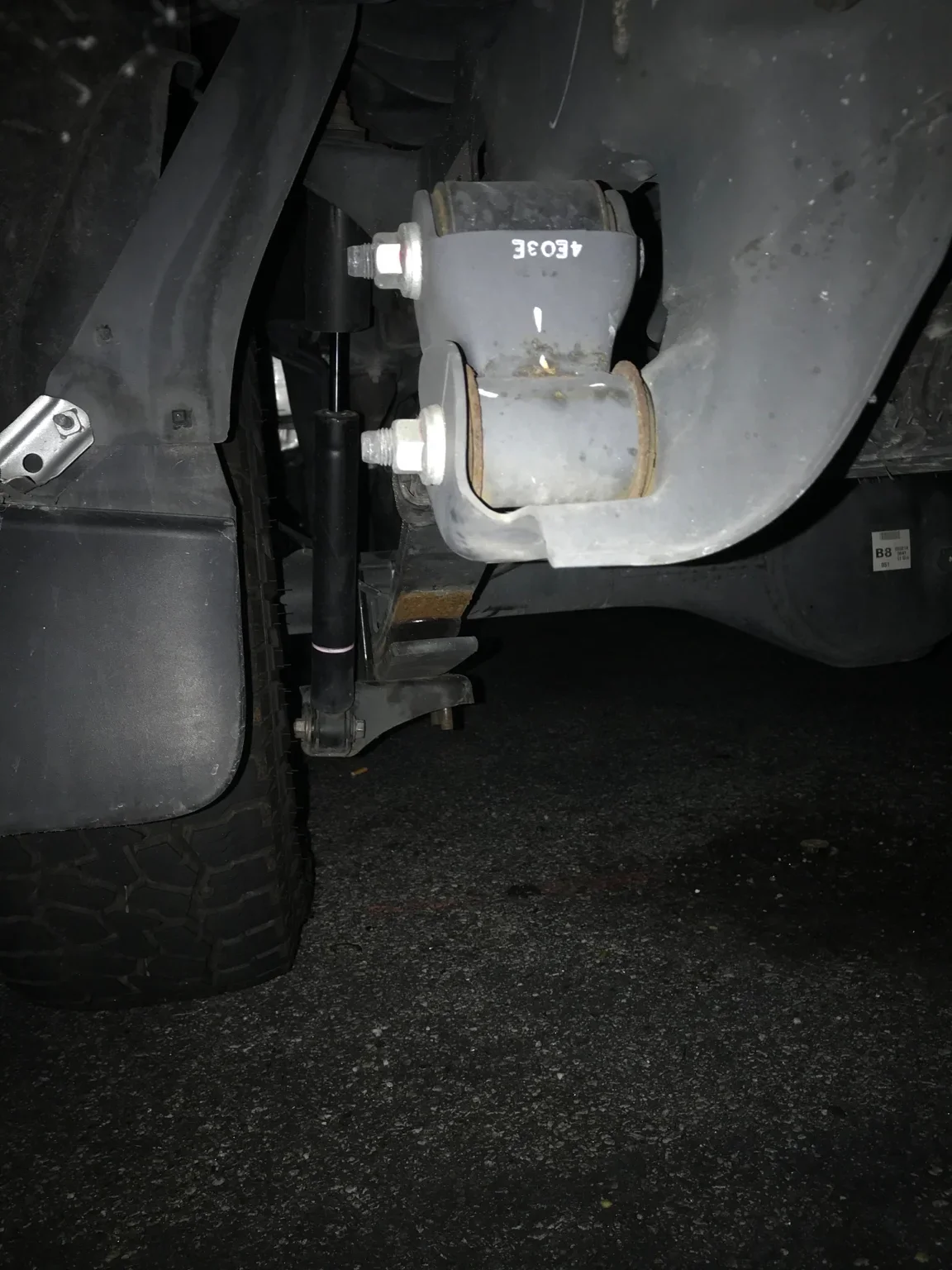

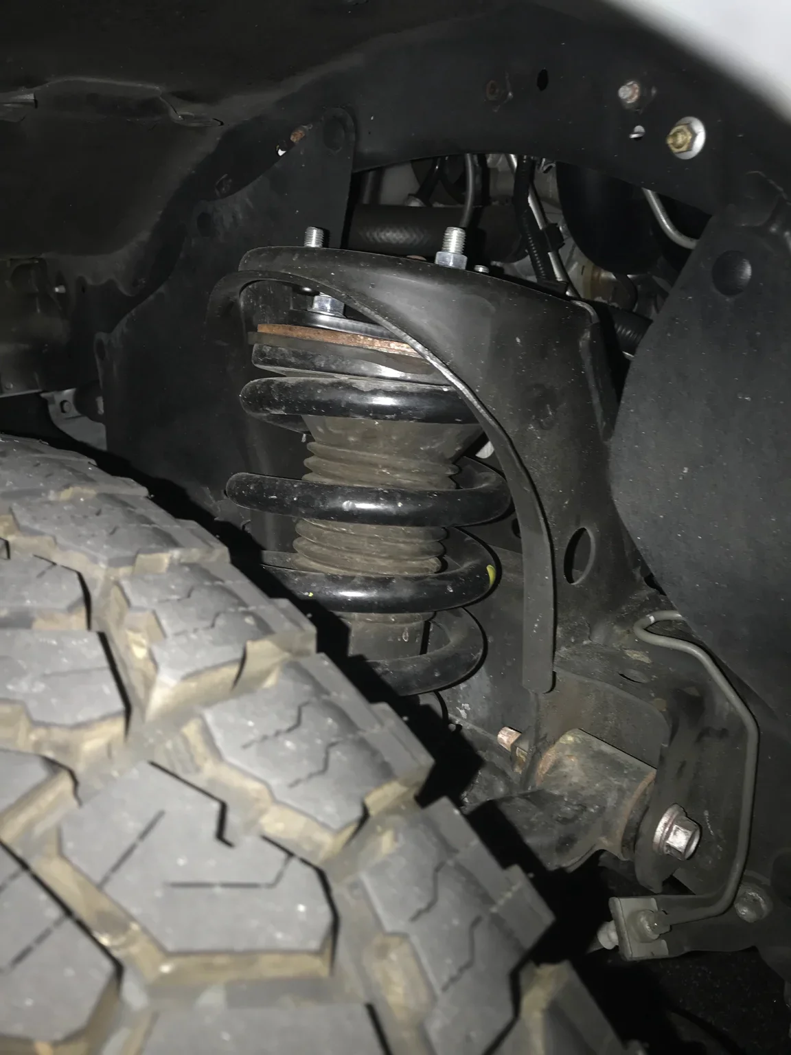

So its been mentioned that I have a spacer in the front and aal in the rear (pics inlcuded) to turn out to be adding 3” lift in the front and 1” in the back. It’s a 2014 5 lug. I’m trying to figure out if I can add more lift and with what. Looking to add another 2 or 3 inches whatever I can.
Thanks!

Unless you find a drop bracket lift for a 5 lug, you’re stuck where you’re at. 5 lugs don’t like to go up.
Not entirely true, like mentioned a few weeks ago we took ryan's 2nd gen single cab 5 lugger from 5" below stock (bagged) to 4" over stock for a total of 9" of lift over all..... BUT !! It took a **** load of work & MODS (custom built UCA'S, Spindles & don't remember about the LCA's) & it's alot tougher configuring SUA's for lift when re springing it...
