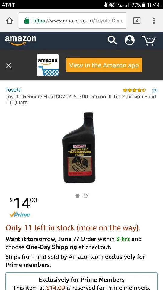

Dang, sorry guys. Just had a baby born and haven't had time to do anything. Getting back on subject. I notice the reservoir is above the low cold marker. That might be the problem. I'm thinking of just topping it off, would it be a problem if the fluid is a different color? I know it's atf dexron lll. I'm thinking of getting this one. Anyone have in put on this. I'm at 80k miles with a 13 tacoma

It might just be PS fluid in there if it doesn't smell like ATF or look like ATF. I would flush it if it hasn't been done and has 80k miles. If it's low check for leaks.
1. Warm up truck for ~15 minutes on level ground.
2. Shut truck off
3. Remove PS cap and suck out fluid with Oil Extracter or turkey baster.
4. Refill PS reservoir with new ATF Dextron III fluid to ~middle of cold/hot mark
5. Put PS cap back on and start engine move steering wheel back and forth Lock to lock for a few minutes, this will pump fluid through the system. Shut truck off.
6. Check PS fluid level and add more if needed.
7. Repeat step "5" hold at lock for a few seconds each turn.
8. Do this until fluid is just below hot full line and looks new.
9. Check after a day or so of driving and fill or remove fluid as needed.
