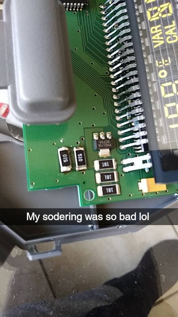

Compass/temp gauge fix
TacoBOB77
So mine went out took it apart looked inside the problem seems to be the 510 thingy not having contact bc there is not enough rosin so sodered the Gap and like magic it works now. any questions let's talk be happy to answer any questions about this fix including tools needed.you can see my Snapchat for my vids I could not upload here
Alchemyy7@snapchat[emoji41][emoji106]Snapchat-602482888.jpeg1537901024309.jpeg1537901003578.jpeg
There's another idea someone had and used traditional resistors too.
Reflowing is allot easier Imho tho, no need to reinvent the catfish right?
Yeps, done it a few times... There's a YouTube video too. Good yob
