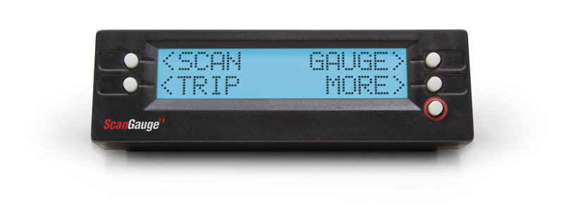

some run a scangauge tool for a more accurate temp reading + other readinds
i still need to dabble with one i have
Scangauge won't give anything if the temperature sensor is NG.
