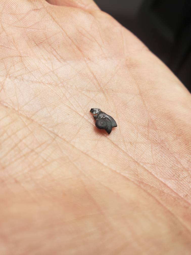

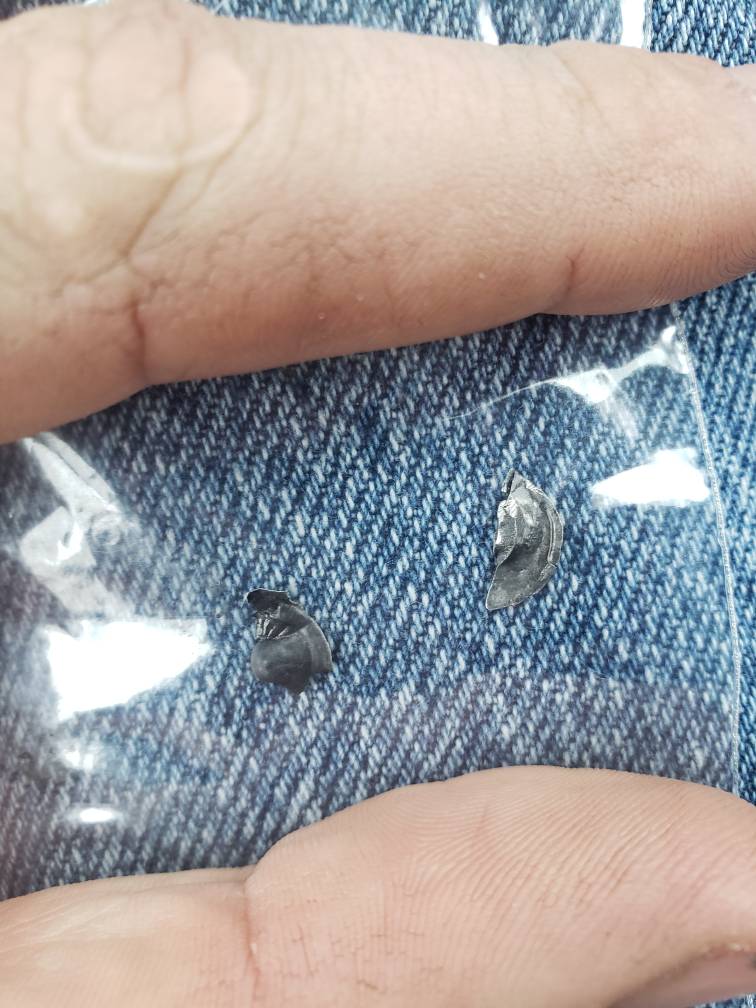

Changed my rear differential fluid and found 2 things just hanging out on the drain plug. Was just changing the fluid to change it.20200422_155009.jpeg20200422_155006.jpeg20200422_154957.jpeg

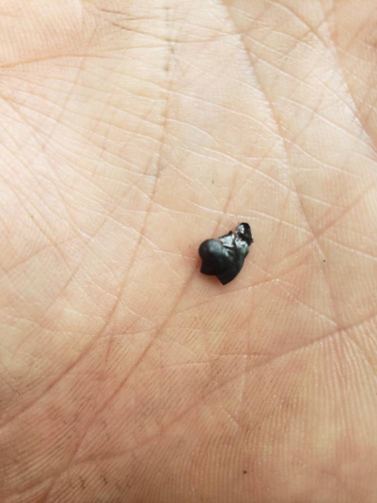

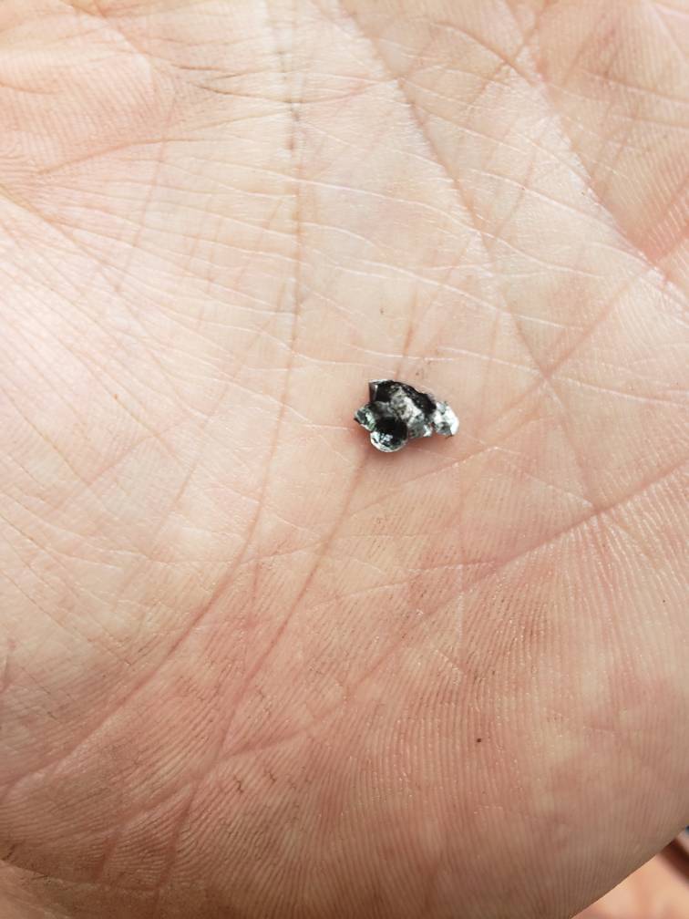

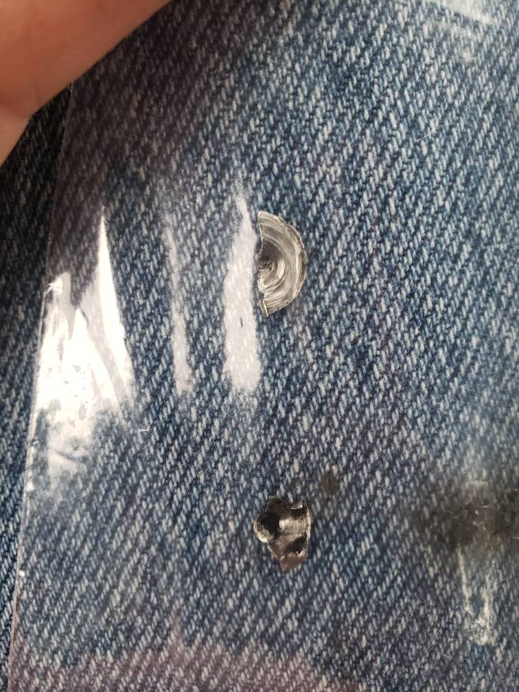

I looked at them really close and it looks like it's from the factory where the holes were drilled and did not go fully through and when a bolt was tightened up. The metal peices fit together and had a point to it. The oil looked very good for 100,000 miles. There weren't social distancing though lol
I see pieces of pinion, like mentioned any excessive whining on deceleration ?? Sad truth is it might grenade the next time you roll down the street or it may last the lifetime of ownership... Only thing certain is when it DOES blow, you'll know it haha
Not concerned with it. Not making any noises. Its looks like part of a bolt hole that wasn't fully drilled out from the factory and when the bolt was put in it pushed it out.
Looks like slag chunks, like you said. Just keep an ear and eye on it. Might want to do another change in 3 or 4k.
