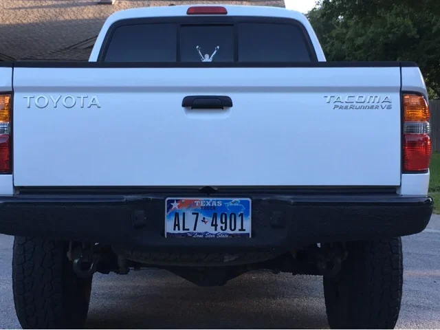

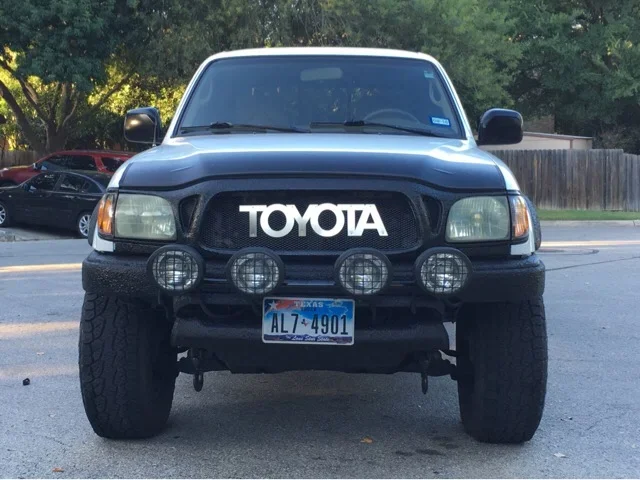

I've had good luck with Herculiner bed liner paint. If you're going to paint your chrome bumpers you need to first sand it down and get all of the chrome finish off. This is a time consuming process. Then you need to wipe it down with acetone.
Good luck!ImageUploadedByTaco Forum1473475338.026508.jpgImageUploadedByTaco Forum1473475378.631199.jpg
