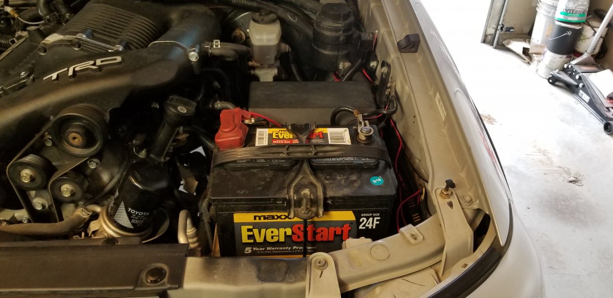

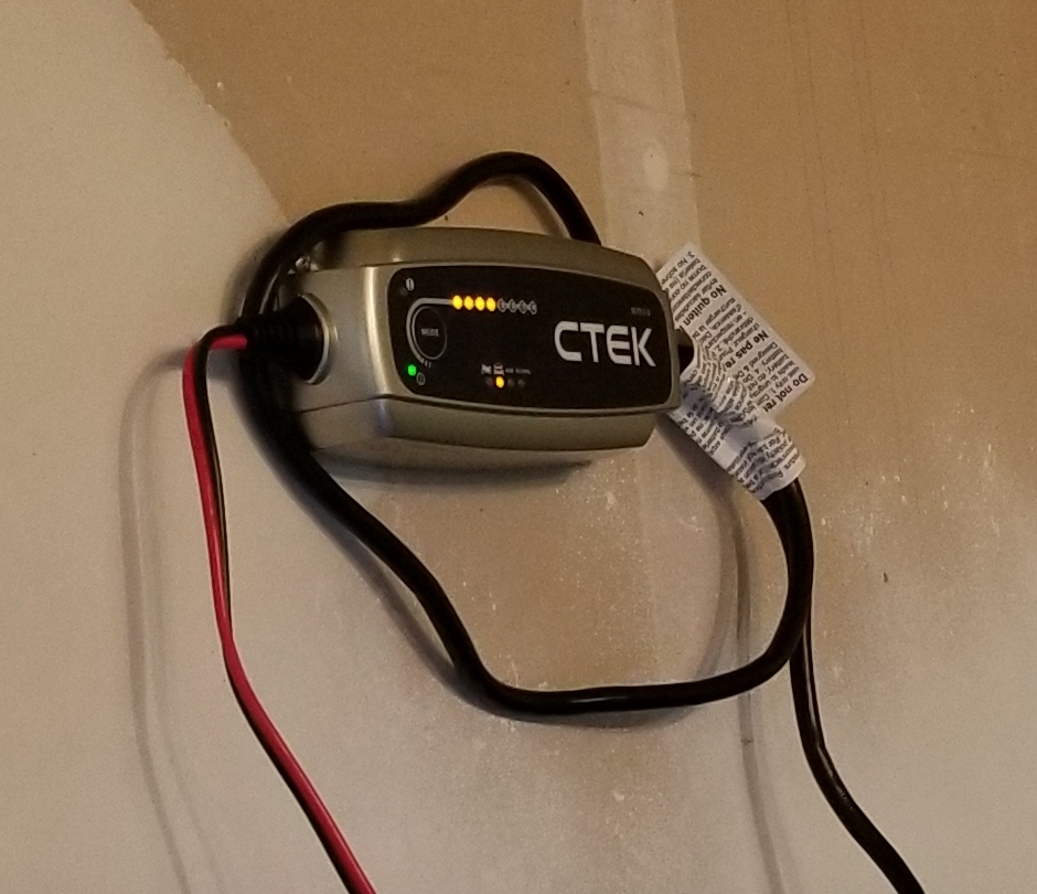

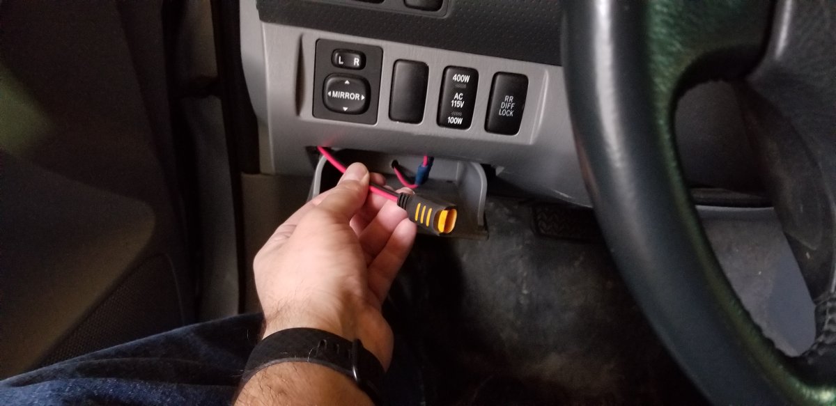

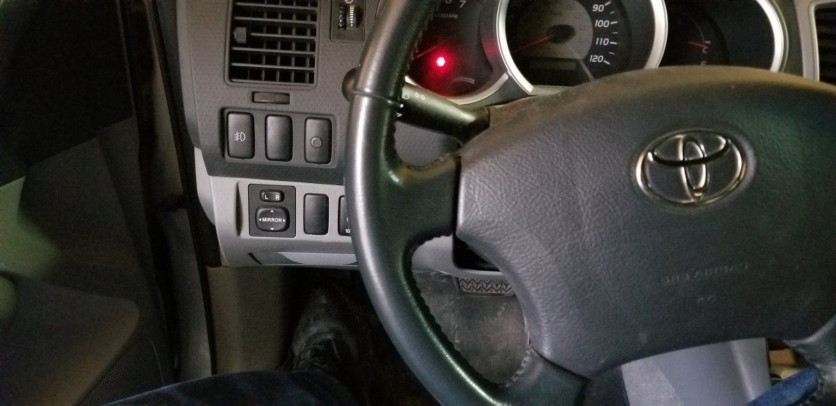

I grew tired of popping the hood every time i was done driving (i never know if ill be driving once a month or once a week). The alligator clips we all know and have used (yeah even those) worked, but grew tiring. I wanted a way to charge the battery without popping the hood,fussing with alligator clips. Luckily the box the charger came in did supply a wire harness with eyelets for permanent connection to the battery.
Whipper again steered me to an extension cable made by the company with a weatherpack connector.
Today my buddy and i hooked the eyelets onto the battery and ground, ran thru firewall, up the kick panel, into the change holder on the left of the steering wheel. I then lazily (3hrs sleep) mounted the charger to the wall next to my truck. Now i just pop the change door open and click the connectors together. Done.
I always have my window down, so no big deal. Its actually a safety thing.. i cannot miss the fact the battery is charging and drive away ripping wiring apart.
So i went from popping the hood and arguing with clamps, to this.
You cant even see the eyelets in the pic of the battery.
