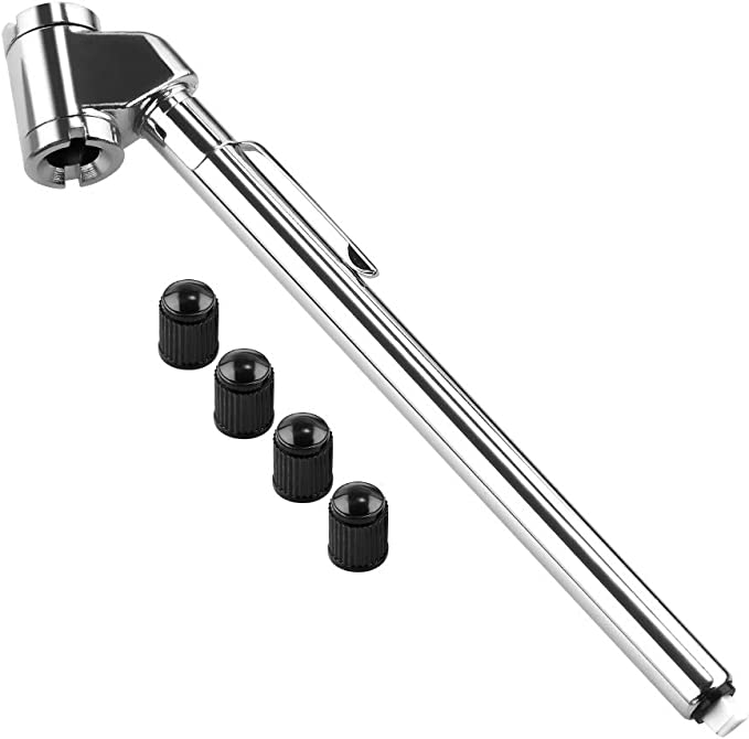

Check the tire pressures.....including the spare. Nothing like having a flat, installing the spare to discover another flat.

<edit> As a follow up. Lower the spare and flip it so the valve stem points to the road. Set the stem's position as near to the rear as possible. This will make checking the spare's pressure fairly easy.
