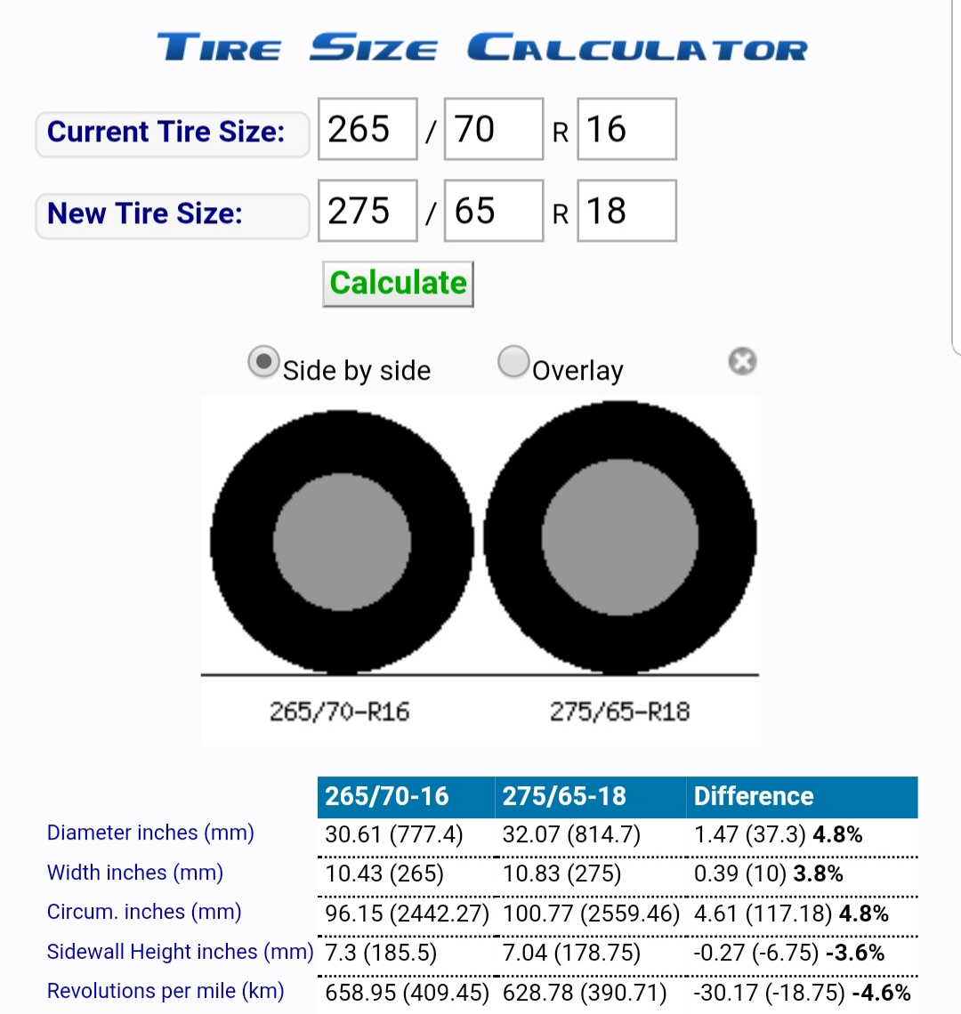

As Nancy said, the tires are not that big.
Here's the comparison of the stock size and the size u have now.

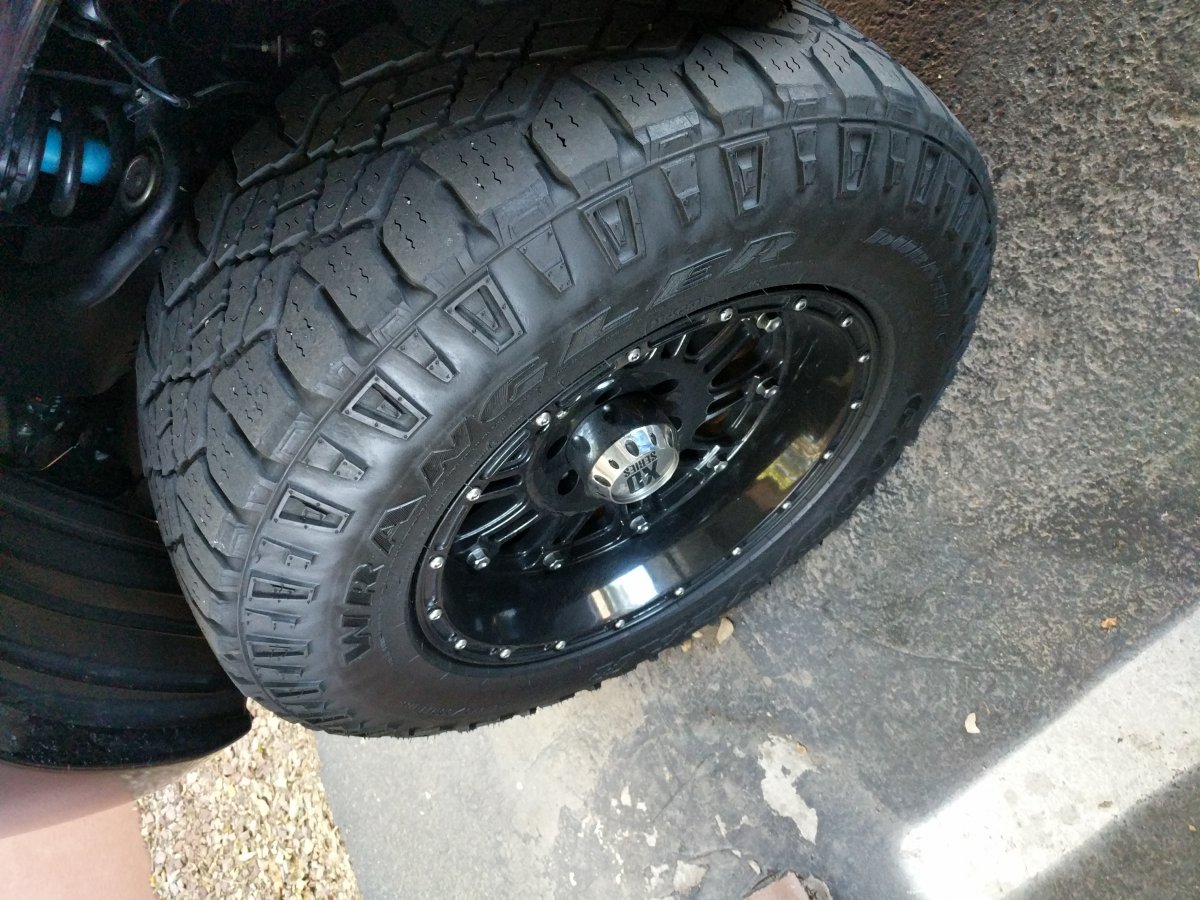

I'm running 285/65X18 Nitto Terra Grappler 2 A/T tires and they are not loud at all. Definitely as others have said aggressive tread will make all the difference. But also check for wheel bearings as they can also cause a loud howling if dry or badly worn. Pics of your tires will help. Welcome to the forum.......PS, power and MPG will suck with oversized wheels and tires on any vehicle.
Thanks! So ya, they are pretty aggressive "mud" tires... Goodyear Wrangler Duratrac. I'll post a picture soon (My HD camera makes them too large to load....) I really appreciate the input! The "howling" noise quietens the faster I go.....

Tracs are not muds. That's an all terrain.
They just have larger blocks and voids.... Yet siped and a harder compound. Sometimes called a "tweener".... It's in between... But the tire is specifically an all terrain
I have them and they are not very loud (subjectively of course)... Rotate them every 5k
