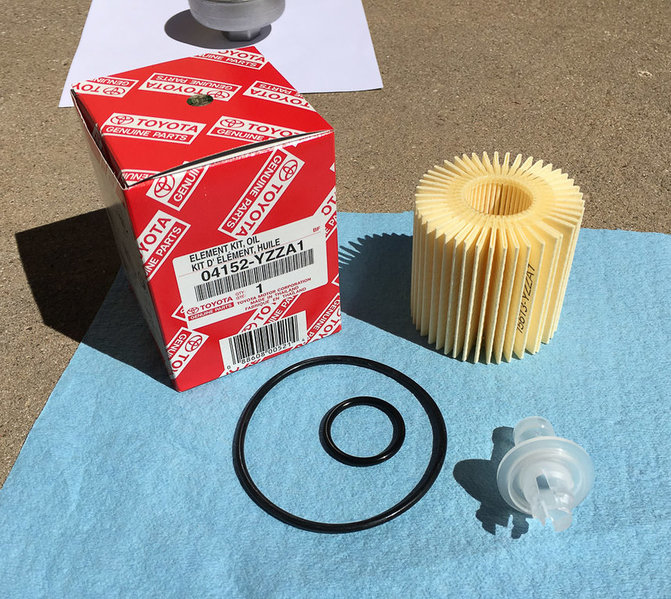

I have a 2017 Tacoma and took it in yesterday to have the 6 month oil change (which is free for life) but I was looking at the print out...and it said element change $42. What is that? I didn't pay for it or anything but curious. I'm used to changing my own oil with the filter and oil but is this something new?
It’ll be a filter of some sort. A filter “element”. Probably the oil filter in this case.
You don’t see it referred to as that very often but the element is referring to what the filter actually uses to filter with I.E. paper, polyurethane foam, etc.
It’s no longer a spin on filter for the new trucks. Just the filter medium (element) is changed inside a filter housing.

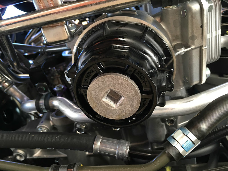

You break the drain plug loose, insert a plastic piece into the housing so it drains, then remove the lower part of the housing. A special service tool is needed for the housing but it can be found pretty much anywhere. Don’t forget to swap the o rings!

I never have anyone change my oil since a local Toyota dealer forgot to re-tighten the oil filler cap on my 2002 Tundra ( back in the early 2000's). My brother had a deal charge him extra during one of those "life-time" free oil changes during a recent visit with his 2015 4-Runner. He now does his own oil and filter service. You could do this service yourself for under 42 bucks. Just buy your oil at a local Walmart and use the OEM filter element. Just purchase the cap filter wrench (motivtools cap wrench designed for toyota oil filter service)... Lots of videos on Youtube showing how to change the oil on a 3rd Gen Tacoma.
Honestly, a very easy job!!
