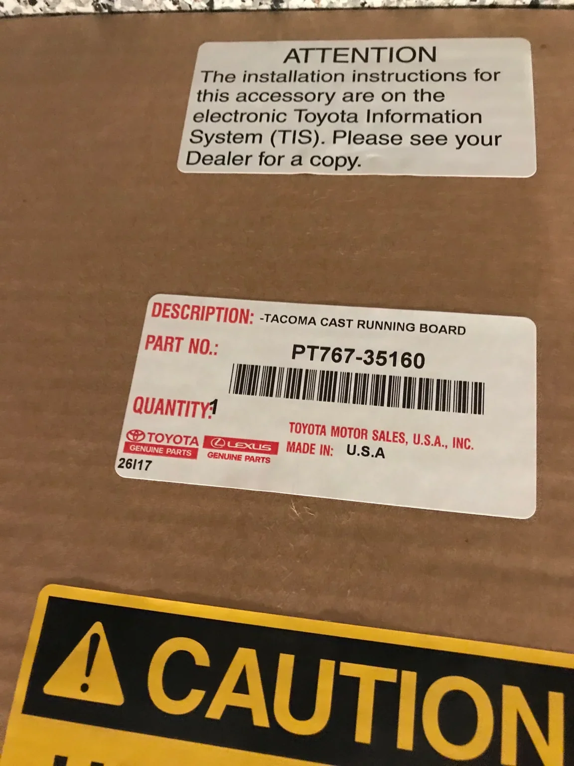

Ordered new running boards from Toyota but came without install instructions. Any help?ATTACH=full]14380[/ATTACH]

What ones are they? Tube? Predator? Long bed? Short bed?
The bolt hole should just line up and you bolt it on. It will be easer with two people. You can use a jack to hold one end up in place if you don’t have the extra set of hands.
Got everything I need to install. They are for a double cab short bed. They are a cast aluminum platform.
They are easy to install and straight forward. Hardest part is getting the first bolts started and lining everything up if you are by yourself. If you have someone helping it’s easy. Start all the bolts and get them hand tight. Look it over and make sure it’s lined up and tighten the ends first and then the middle.

Good advice. They’ll go on in a cinch. If you can get some help from someone to help hold until the bolts are threaded it’ll go quicker and easier.
