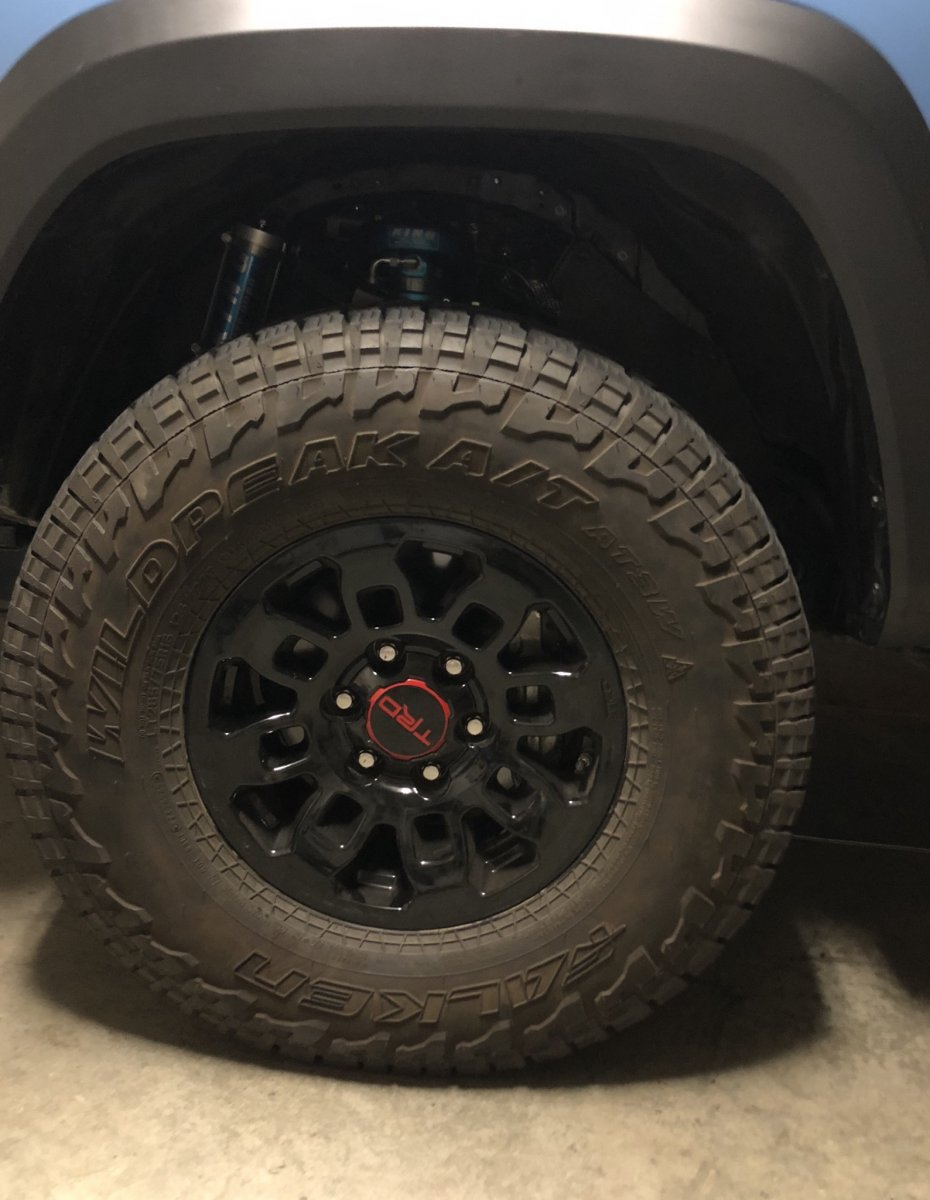

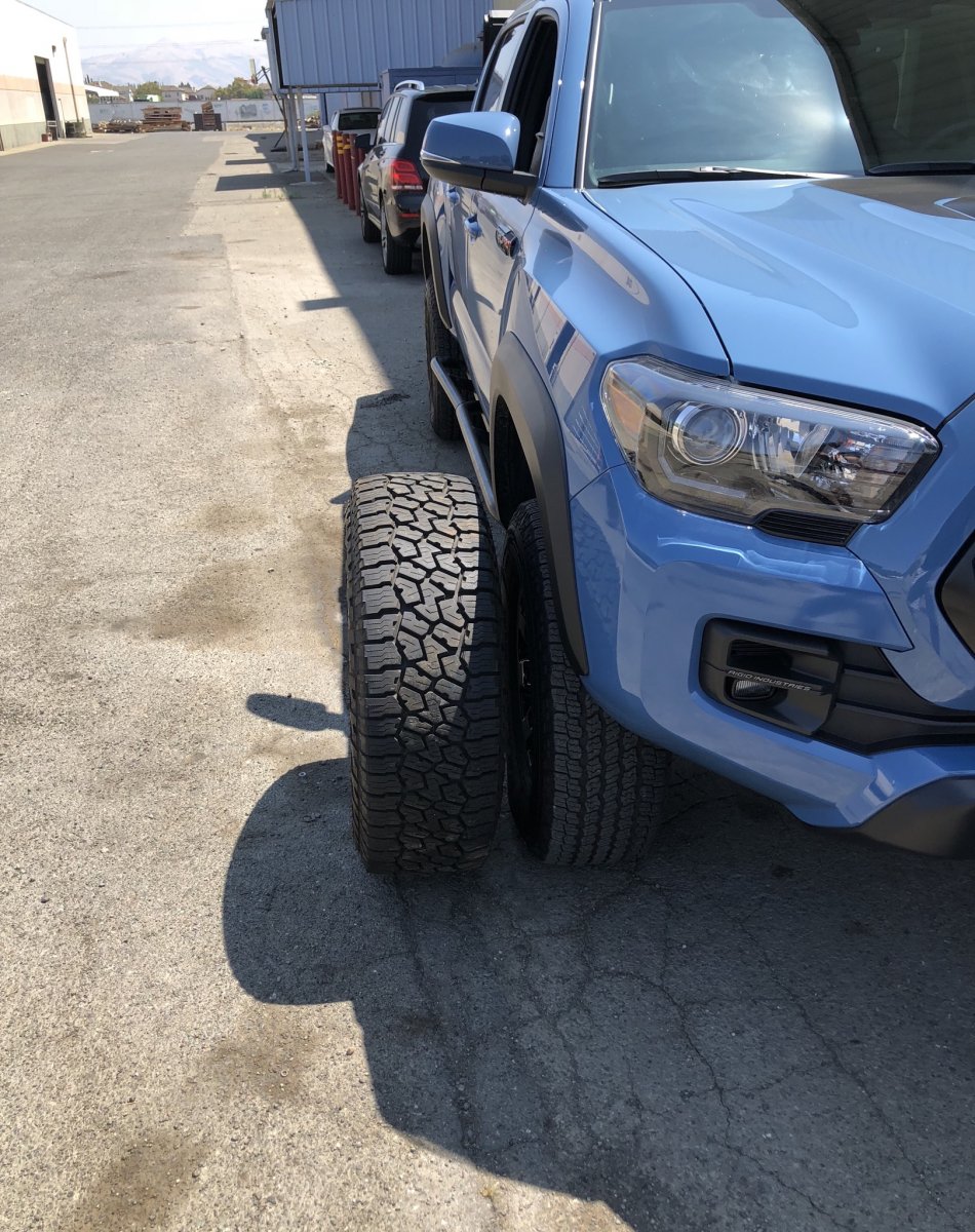

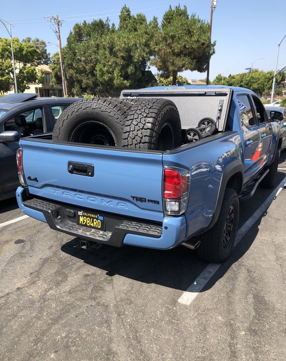

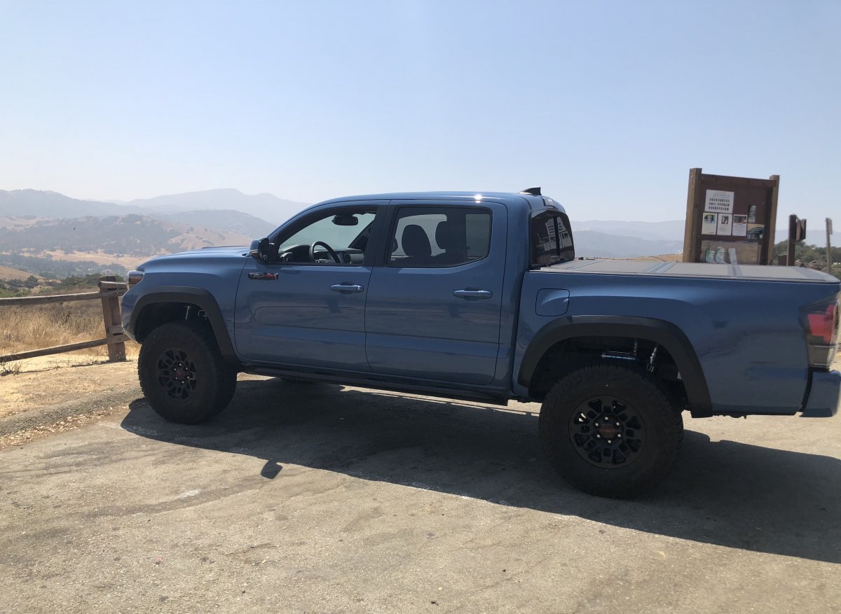

D24D1194-9A62-4B9D-9AAE-5A6A0FBBD637.jpeg 76FFB07E-49D8-46DC-98CF-172FE8CA6288.jpeg 8821CA9C-70B8-428D-A015-4D194E37706A.jpeg 55B7880F-9DD7-4322-9019-C977B1FF3E28.jpeg finally got around to put these on. Had some issues with misplaced weights which slapped the calipers.got the issue taken care of. Rubs like crazy at full lock reversing but other than that no issues. So far tires are quiet and look aggressive in person. I don’t know why it looks so weak in photos.

Find where it’s rubbing and take a heat gun and mold the plastic some. Also a good alignment can help some too.
I looked every where and I am not rubbing on any plastic what so ever. However, at full lock, reversing I hit my uca’s. Any suggestions on a solution? Is this just a alignment issue?
Let me pull my alignment spec’s I believe they made it as close to zero in both chambers and pulled my caster way out to +4.
Might be hitting body mounts in the back of the wheel wells.
No not hitting body mount.its the uca’s for sure. I just ordered 1.25 wheel spacers hopefully it will be a easy fix
Bora 3/4” would have worked. 1.25” might be to much. Pictures if you mount them. Are they spidertrax?

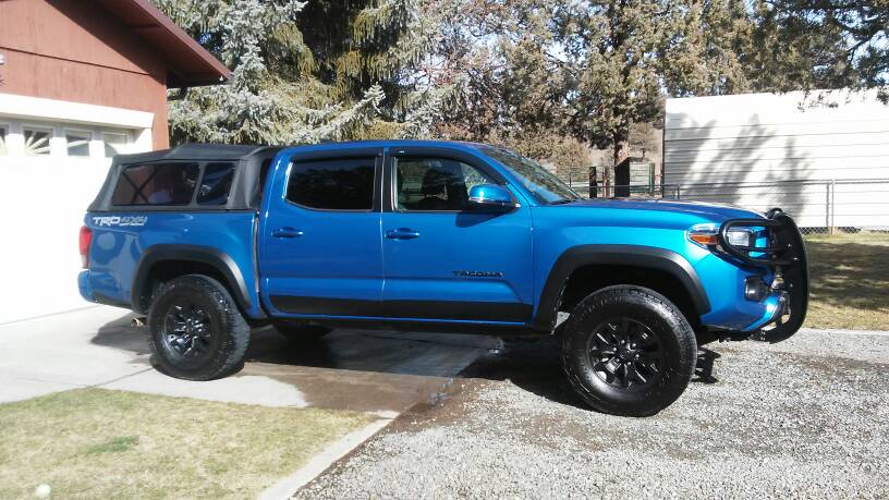

That's where I'm at,...
Caster - 3.7df, 4.0pf
Camber - 0.00 both sides
Toe - 0.00
Rubbing on the A arm is more of a back-spacing issue,... I think my wheels are 4.25 bs and -6 offset. I did have to do some trimming/ molding and will work on the cab mount some time soon, but I'm nowhere near rubbing the A arm.
