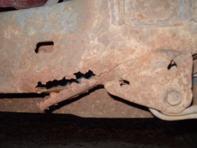

Some of the frames on those 1st gens didn't get a good coating of corrosion protection. I know.....I had a 2000 PreRunner that Toyota bought back due to frame rot just this past Dec. I was lucky and had the letter from them extending the frame warranty for 15 yrs. All I had to do was show the dealer the letter. 3 weeks later they cut a check for Bluebook + 1/2. Rated in excellent condition. This is a pic of what happened to it. Driver side rear leaf.
Rest of truck was in great shape....frame rotted out from under her.
Why did you trade it in?!?! A little duct tape and bondo would of fixed that :)
Very true. 4x4 and a stick. Toyota did me right. They basically bought me a newer truck with less miles. I made a 8k profit over what I paid for the PreRunner when I got it in 2002. So I wasn't hurt any just inconvenienced until I could find another one. Got the drivetrain I wanted just not the color, but I'm still good with it. I shopped for 3 weeks everyday, the bad part was it was around xmas time so Taco's were flying of the lots. Working full time days didn't help. And I needed transportation. I had the free loaner Taco for 3 weeks, they took it back when they cut the check. I had to rent for 10 days waiting for the check to clear. Found the truck a week prior to the check cutting. So put $500 down when I went to test drive. Paid it off 10 days later. Haven't looked back, I'm happy with the upgrade :thumbsup:

Frames rusting yes, but no buy back/fix that I've heard of. As it was they replaced the frames on 01~04, bought back 95~00 from what I understand.
