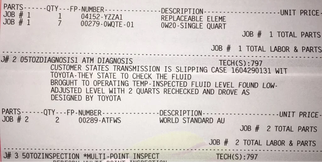

After reading on TacomaWorld how the 2016's are being shipped from factory low on tranny fluid, and having a lag between R and Drive. I started a case with Toyota Corporate. Sure enough 2qts low!!!! Mine is 2016 trd off road with Tow Pckge. Rediculous : /

Just got my truck back from service at Toyota. They also found the truck low on transmission fluid by 2 quarts. According to them, the deceleration vibes are gone... But they are not. I will contact Toyota in the morning about the issue and see where this goes. Looks like I bought a lemon...

Just had mine checked this morning. All was good. Just am FYI, they told me that the engine had to completely cool before they could check it. Therefore I was going to have to wait for at least 3 hours. Luckily they provided me with a rental car until mine was finished.
I thought it always had to be a warm engine? The original post said the technicians warmed up to operating temperature. I have only had my Tacoma since end of April and have been wondering if the hesitation I'm noticing is normal. Guess I should take it in to be checked.
They let it completely cool then brought it back up to operating temperature.
I am very glad to have found this thread. That lag has been frustrating me sense I picked up me Taco 4x4 (I removed the TURD). Love the truck but that lag was bothering me. The wind noise is also bad but that's another thread. I'll check the transmission fluid tonight!
Had mine checked, not quite a quart low . I was told it's within spec. I think the Atkins cycle motor used for a bit better fuel economy and a program update/ fix . Which I think they need to do is hopefully going to eliminate these issues. I drive more than most in these Tacos 1200 -1500 weekly average. I taking the same trips with and without the power ECT button pressed. My fuel economy is within 1-2 mpg's. Now that's cruise control on mostly highway driving.
