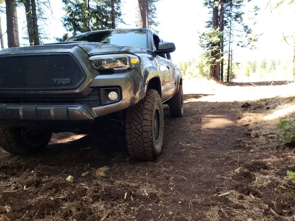

But it is possible to run a 34 x 11.50 with a 2" lift. I've done much trimming tho... lol20200424_130243.jpg
