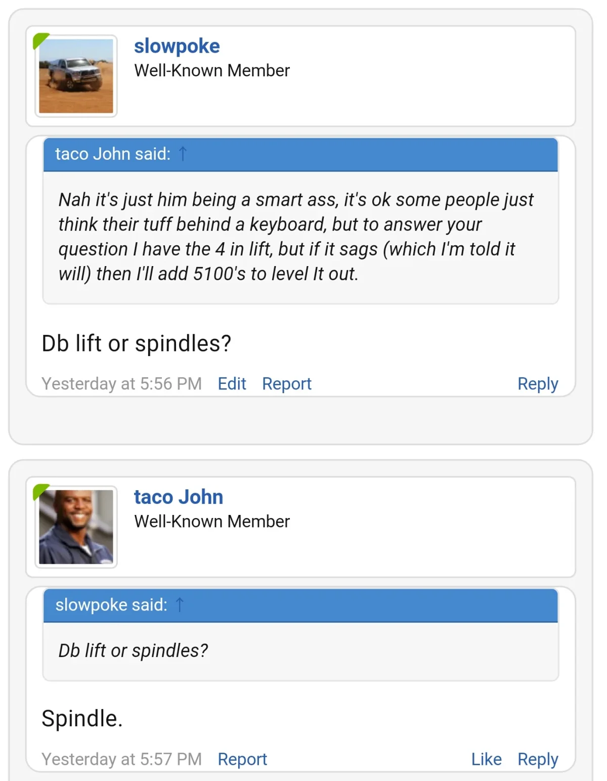

So quick question, since I have a spacer lift and if I wanna get a ARB bumper, will it still sag? Because I remember on a previous thread you told me that it shouldn't sag since it's a spindle lift? I have the lift kit at my house and it looks like it made of good quality material. It's all metal and looks solid. I'll post pics later if you want to see.Nope, not in that pic.... thats a ruff country spacer
I'm sure the spacers are solid, but I think the concern is that spacer lifts tend to put added stress to other parts of the suspension. I know plenty of people run spacers without issues though...So quick question, since I have a spacer lift and if I wanna get a ARB bumper, will it still sag? Because I remember on a previous thread you told me that it shouldn't sag since it's a spindle lift? I have the lift kit at my house and it looks like it made of good quality material. It's all metal and looks solid. I'll post pics later if you want to see.
Neither will sag on its own..... but yes, a bumper on either will sag.So quick question, since I have a spacer lift and if I wanna get a ARB bumper, will it still sag? Because I remember on a previous thread you told me that it shouldn't sag since it's a spindle lift? I have the lift kit at my house and it looks like it made of good quality material. It's all metal and looks solid. I'll post pics later if you want to see.

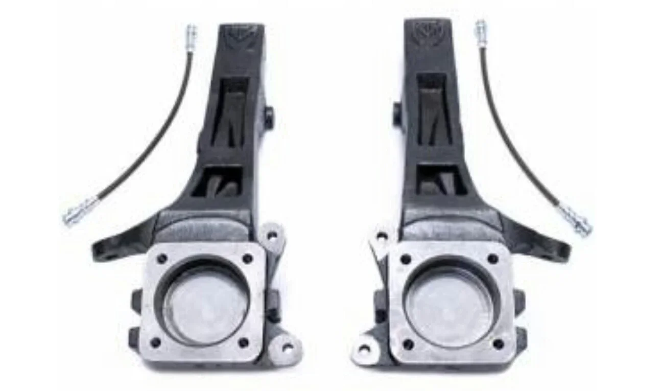

I don't know the difference till now honestly. The only reason I got it was that friend got it on his tundra and said it was good. Funny thing his front shock actually snapped in half as you said, but that was only because he took it on a jump lol.View attachment 9597
See how it looks?
No mention of bumper there, so thats why i said it wont sag..... sorry about that.
