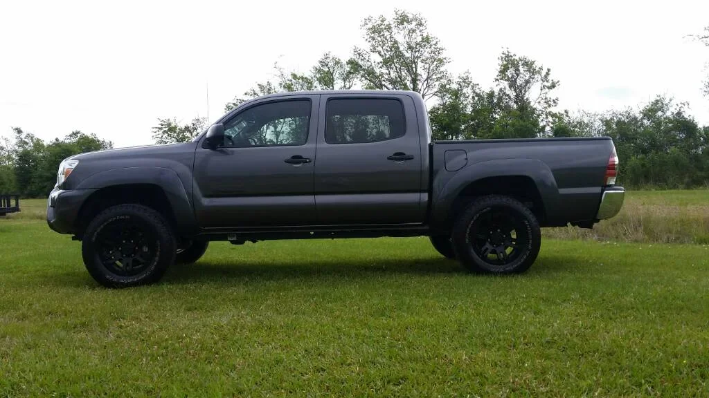

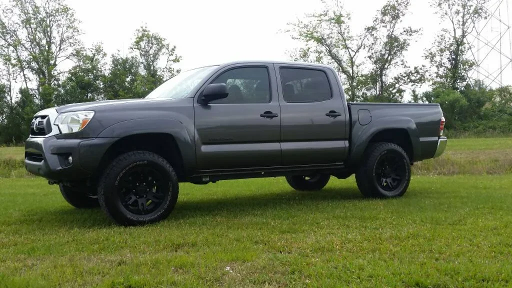

Leveled
What size did you set the front to. Is the back set to stock height? How's it ride. My plan is to run a 255,75,17 tire. Looks great!
That will fit at stock height, they have three clips for height adjustment .85", 1.5", and 2.5" or something like that and what i recommend doing is pairing that with some coils like eibachs. You set the shocks to .85 and with those coils you get just under 3" of lift.
Toyteclifts.com
Thanks guys. I didn't go to the top notch I just leveled it. I did the tear shocks also. Don't see any difference in the ride but I like the look.
5100s provide zero lift in the rears.
They are basically just an upside down spacer lift that bilstien has revalved to take the preload "better".
That said, offroad coils do not take preload as well as base model and sports. The offroad coils are progressive, the sports and non trd models are the exact same linear coils.
