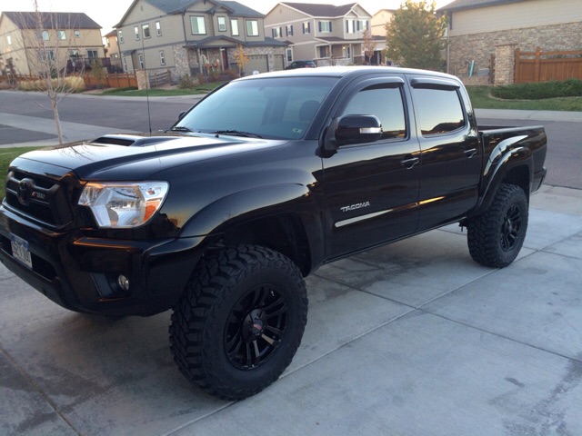

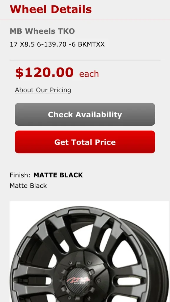

Mastercraft mxt 285/70/17 @ $192 a tire. Wheels are from discount tire 17x8.5 at -6 offset @ $120 each wheel. ImageUploadedByTaco Forum1417661267.280334.jpgImageUploadedByTaco Forum1417661284.579542.jpg

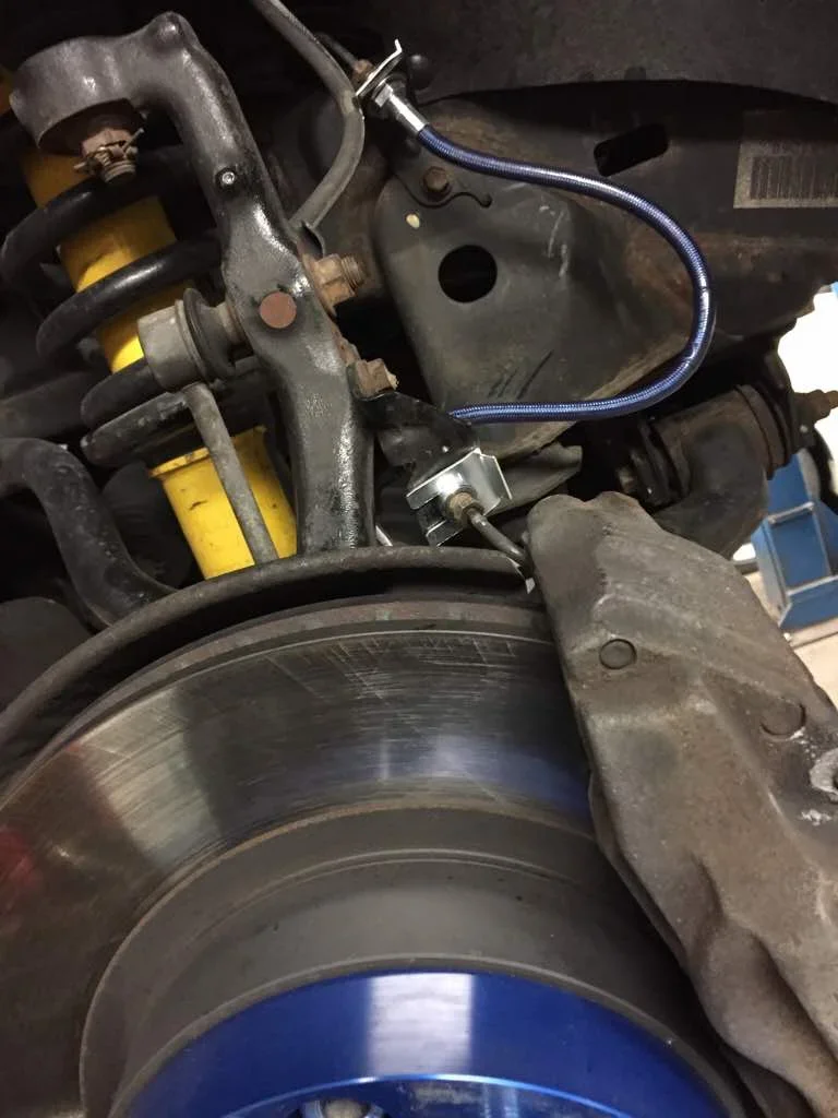

Front hub with a pressed wheel bearing included!

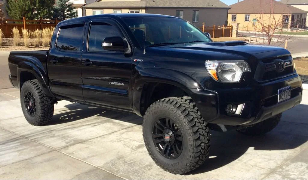

Frame might be replace in March or April. So I'm just getting by with a set of OME front struts and 885 OME springs. I had them from my old FJ they didn't lift it high enough with the 305/75-16 on the FJ. So I installed them in the new Taco with 2" rear blocks , u bolts and longer rear shocks. They give the Taco about 2" of front lift. Tires are new BFG KO's 285/70-17.
