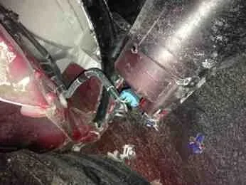

Here's a pic of the wire harness for the fog light. This is just behind the bumper. Crawl on your back just as I did under the front of the truck. Use a flash light if you have too. This is what you are looking for. The little blue wire harness just below the headlight. Sorry it's a little salty in Wisconsin .ImageUploadedByTaco Forum1391549633.344417.jpg
