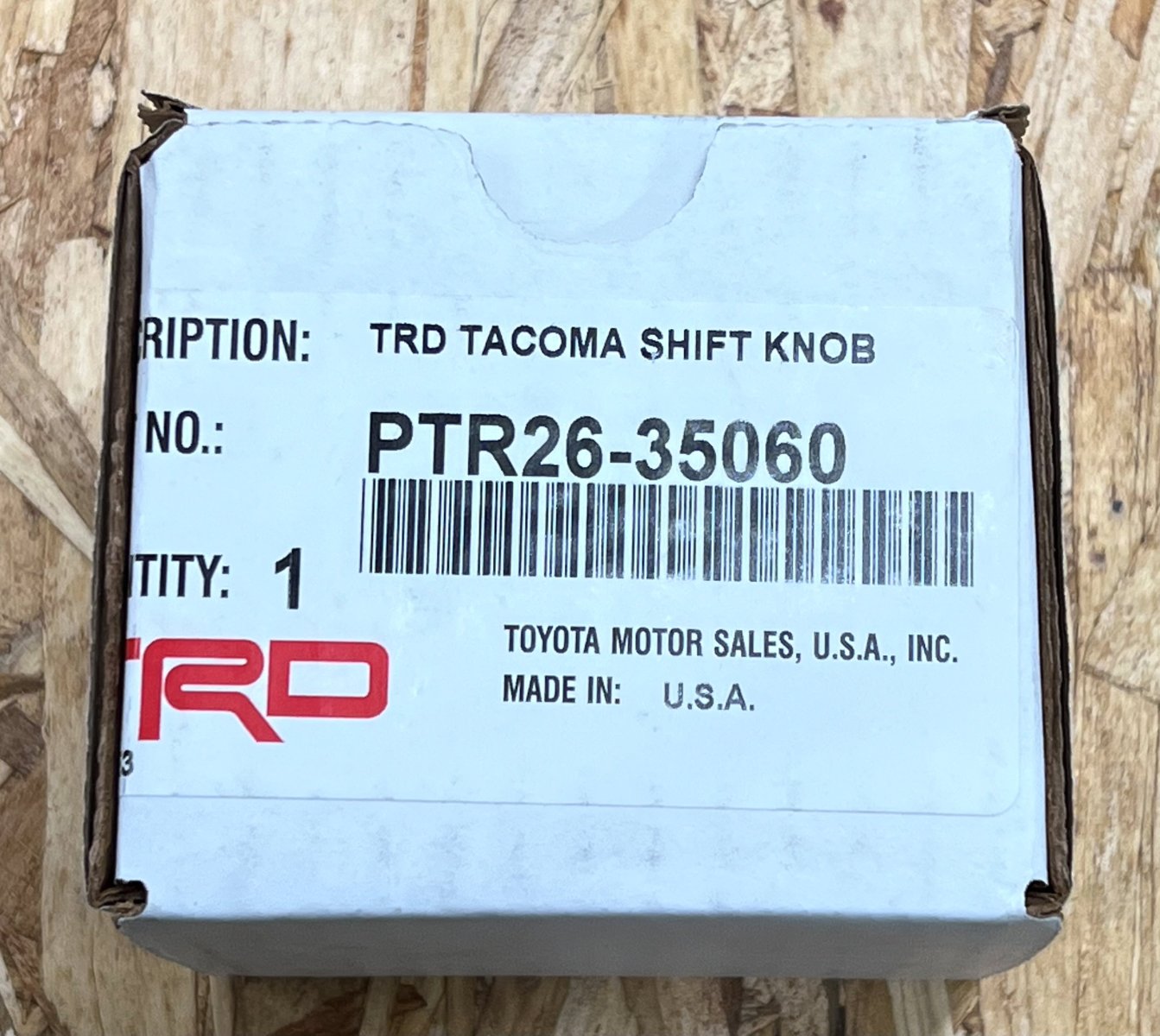

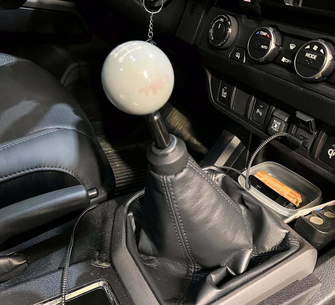

The first phase was installing an OEM TRD knob ($58) with a Dobbs Hardware trim cover ($20) to secure the boot. The knob is big and fits my hand better than the OEM or other ball knobs I looked at. The feel was better than stock.

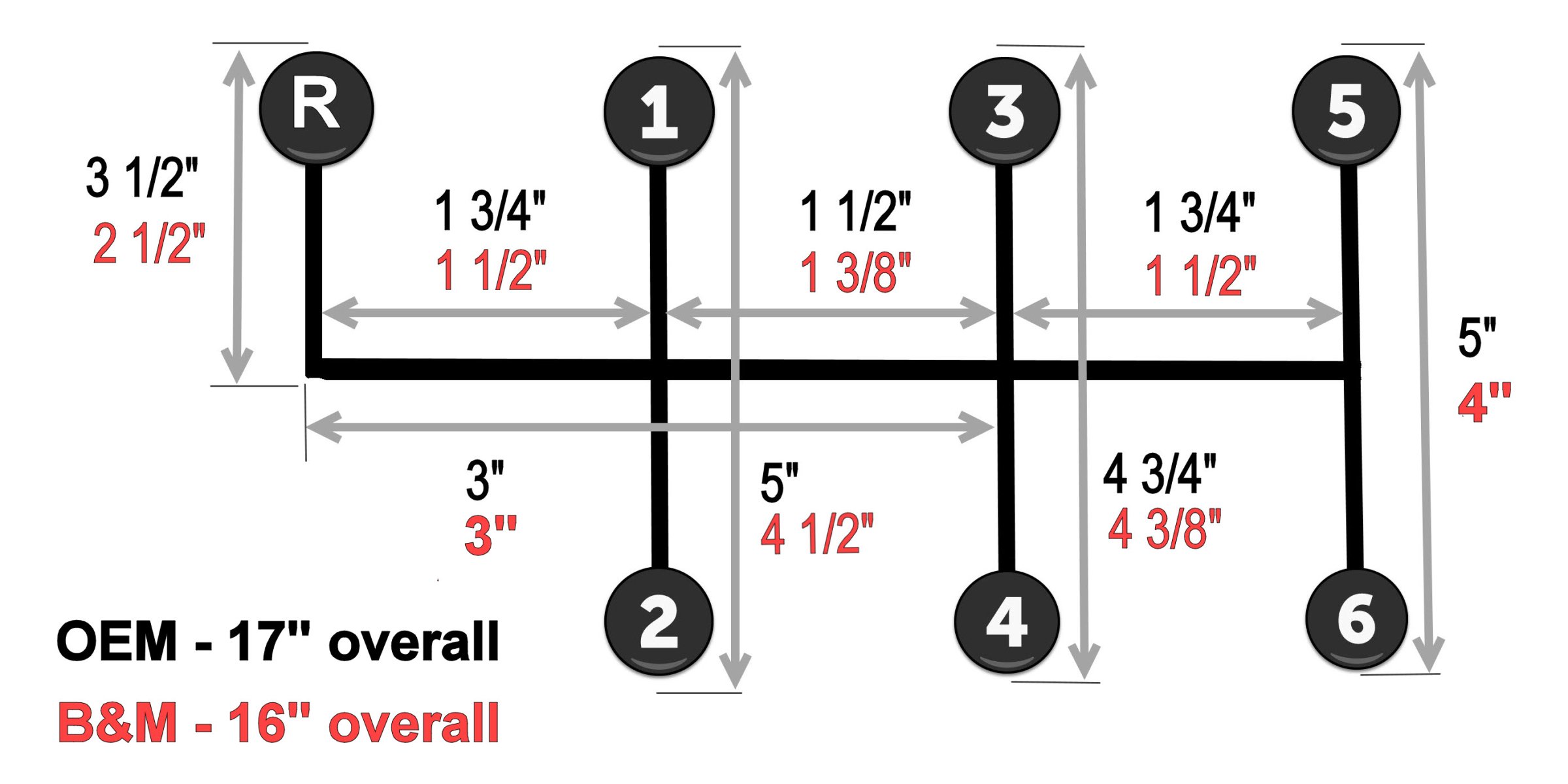

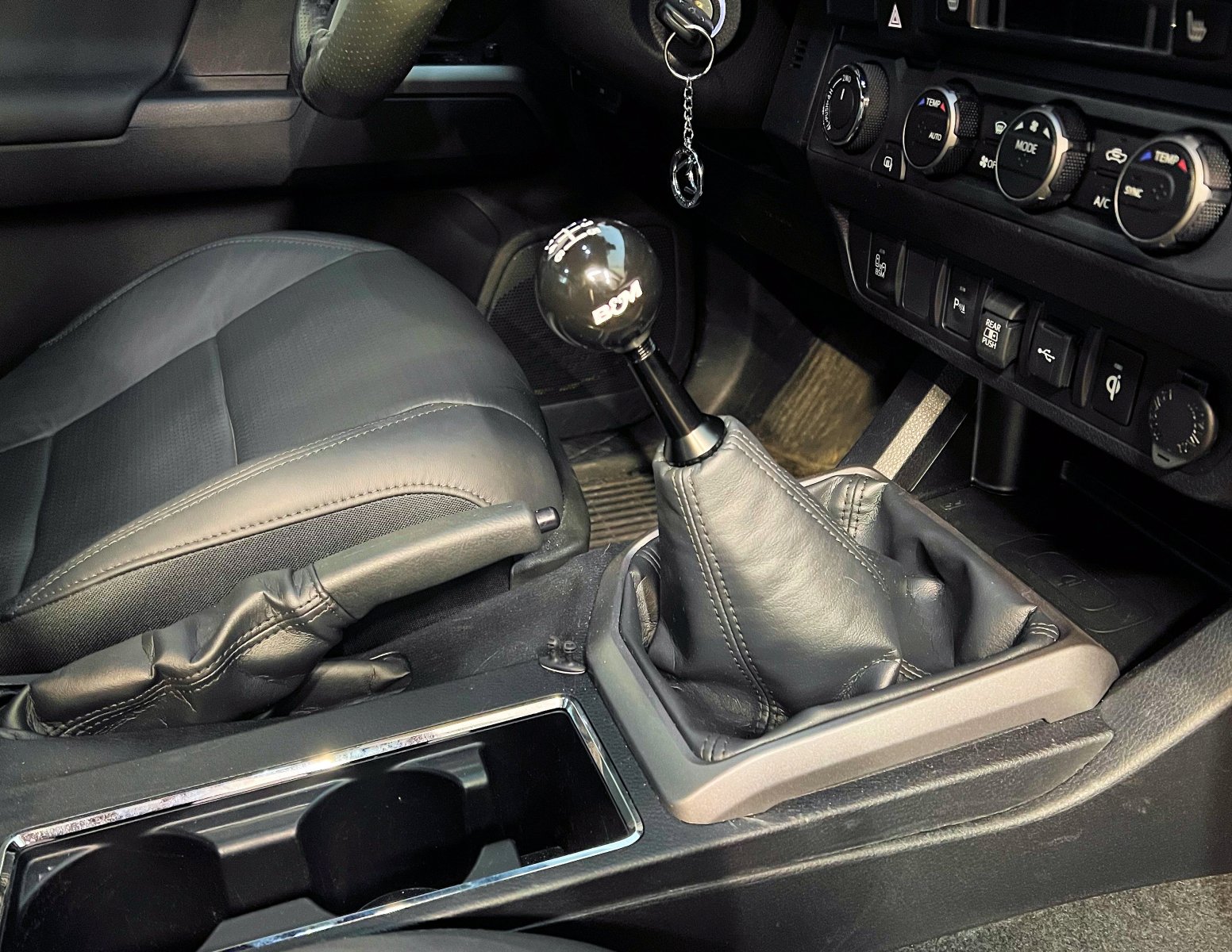

I looked into aftermarket shifters and decided on the B&M 45204 Sportshifter ($297). I could have installed it myself, but for the time and effort, had the local Toyota dealer install it for $143.
What a difference! The gates are tight and throws are less. The overall feel is much more satisfying than the OEM setup. As a manual fan, I'm very satisfied with the results. Nothing like an old-school ball and stout shifter with nicely defined gates. Makes me smile all the time, not just when driving all out.

No lights; it's a solid ball with etched gear pattern and B&M logo.
Yes, have to pay a bit more attention to shifting. But once you get it, the smiles come with every shift-up or down.

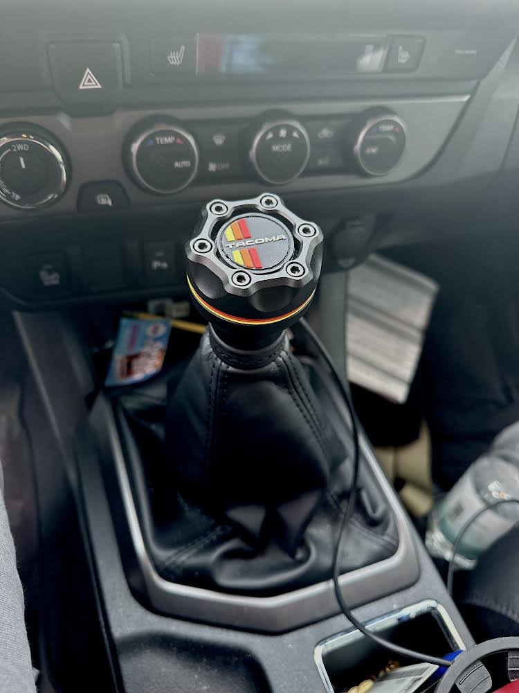

I think the stock one looks extremely ugly. This was one of the first upgrades I made.
