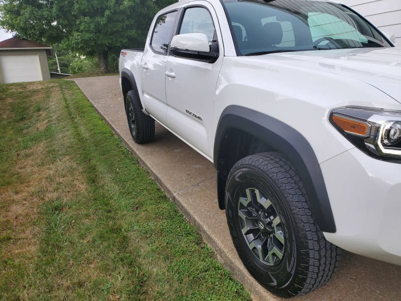

Just got tired looking at it and gave it to my brother 150 k miles. Spraying the interbody and frame with liquid film it worked wonders . This month I purchased a 2020 Tacoma off road in super white. Just finished spraying interbody and frame with liquid filim. If it last like the 1996 model I'll be 92 years if age.
In 1996 I purchased a new Tacoma 4W . I drove it for 24 years. It looked new and ran just like it did when it was new. Over the years It only required regular repairs like brakes etc
Nice truck. Is filim some type of rust proofing? Would you recommend your average owner do it themselves?
Yes....its easy to apply. Use air gun sprayer or buy the hose and spray tip from Liquid filim. Wear eye protection. Spray inside and out the frame and any areas that salt touches. I insert the spray tube on the frame the length of the tube. I then spray as I slowly pull the hose out. Take all the rubber plugs out and spray inside the body panels. Reinstall the plugs. It's easy to install. Just make sure you wash and dry the areas before applying.
