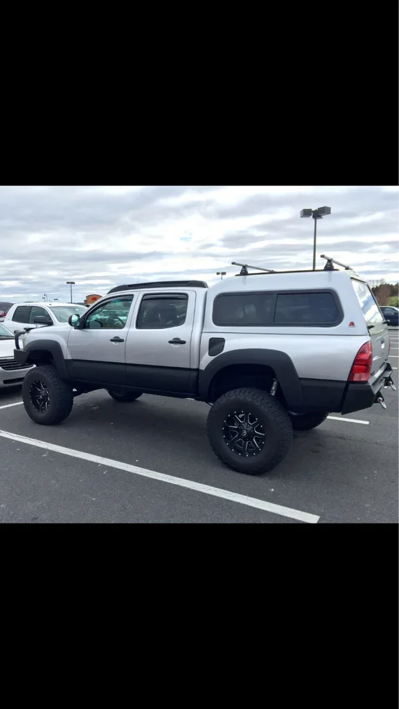

Nooooo 886 springs if its factory! Mine is 1700 lbs. heavier than it was off the assembly line and the 886 springs from Old Man Emu are for about 220 lbs of additional weight on the front of the truck!ImageUploadedByTaco Forum1460510876.762413.webpImageUploadedByTaco Forum1460510899.877869.webp
