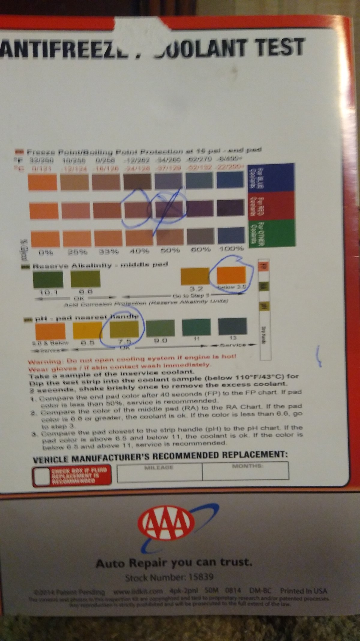

i did a little AAA auto coolant test strip test on my old 56K miles Toyota SLLC thats still in there and based on the results the freeze/boiling points are -12/282 degrees fahrenheit and the ph level is 7.5 which is still OK based on the test but at the low level seems to be on the way out with another 5-10k miles IMO. so toyotas recommended change intervals at 100k miles initial and then 50k afterwards seem to be early but somewhat accurate. im at 56k miles(second coolant change) on the OEM SLLC and it still has some life left. if you have AAA auto coverage you can get a Fluid test strip package for free where they have service centers i had gotten 2 of them that test all engine fluids in the car, pretty cool allows you to get an idea on how good your fluids are, seems pretty accurate.
