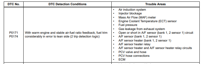

The following is from the "2005 to 2006 Tacoma OEM Repair and Wiring Manuals"
Anyhow, this code flags as a System Too Lean (Bank 1).
You probably need to schedule a visit to the dealer. The diagnostics get pretty complex and need specific meters for measurements.
Possible contributing causes......

I s'pose you could load the part cannon and begin replacing stuff until it works. Take a close look at the list of "Trouble Areas." Not much there for a DIY mechanic to handle.
