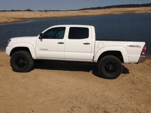

Happy as hell with my new 2015 Tacoma. The truck was tricked out by the dealer (big tires, black rims, etc) just wondering why it has a slightly lower rear eand than the front.
Or the rear leafs are sagging. Unlike on new taco's but possible. Dealer recall for my 06.
Looks like maybe they added a leveling kit. I put in a 2 1/2" front and 1" rear. initially I only did the front but did not like the front being 1/2" higher than the rear so added the rear 7/8" blocks which lifted the rear 1" so the rear is now 1/2" higher than the front. I have 32 1/2" tires with no clearance issues after removing the mud flaps and the very small front mud guards.
