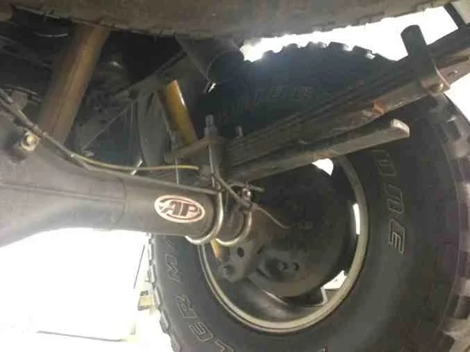

As I sat in my garage admiring my new 2013 Tacoma crew cab 4x4 today, I noticed the rear appears to sag a couple of inches compared to the front. Other trucks I have owned have had the reverse problem, and while I do have a 180lb fiberglass canopy on, I was surprised to see this. Has anyone else noticed this, and is there a solution? I know it is a minor thing, but if it sags not, I can't imagine if I actually put something heavy in it. I have the TRD off road package. Thanks for your feedback!
Need to add a leaf. I went with a over leaf helper spring. I needed it to tow my boat at night. Cars would flash their lights at me thinking I had my brights on. It is a common problem. Most people use trucks as cars and like the soft springs.
Tacomas have crappy rear springs. I bet the dealer will say that they can't do anything about it because 2013s aren't covered in the TSB.

My truck sagged and hit the bumpstops with only 500lbs in the bed. I had the TSB done and it still sagged and hit the bump stops with the same load but not as often as when the original springs were on the truck.
I talked to the dealership about it and they said that is how Tacoma's are supposed to look. I then called Toyota customer service who told me to take it to the dealer. Neither claim to know anything about a TSB. Sort of stuck.
I think and someone correct me if I am wrong, but don't the 2013 Sports have the TSB 4 leaf pack? If so I would use that info to try and get Toyota to put the tsb leafs on your truck. I went through the same BS when I bought my truck in 08. My truck was not covered at the time by the 4 leaf TSB, I complained and Toyota sent out a regional tech and he signed off on me getting the 4 leaf tsb done on my truck. :thumbsup:
