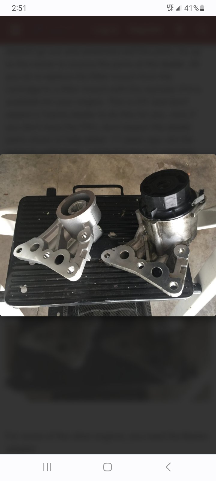

Hi,
I have a 2023 Tacoma V6 that I would like to convert the oil filter to a spin on. I saw the Baxter and this came up searching. This is claimed as an OE part Toyota does sell but no part numbers. It looks to be a direct swap to the factory housing.
Thank you,
Dustin

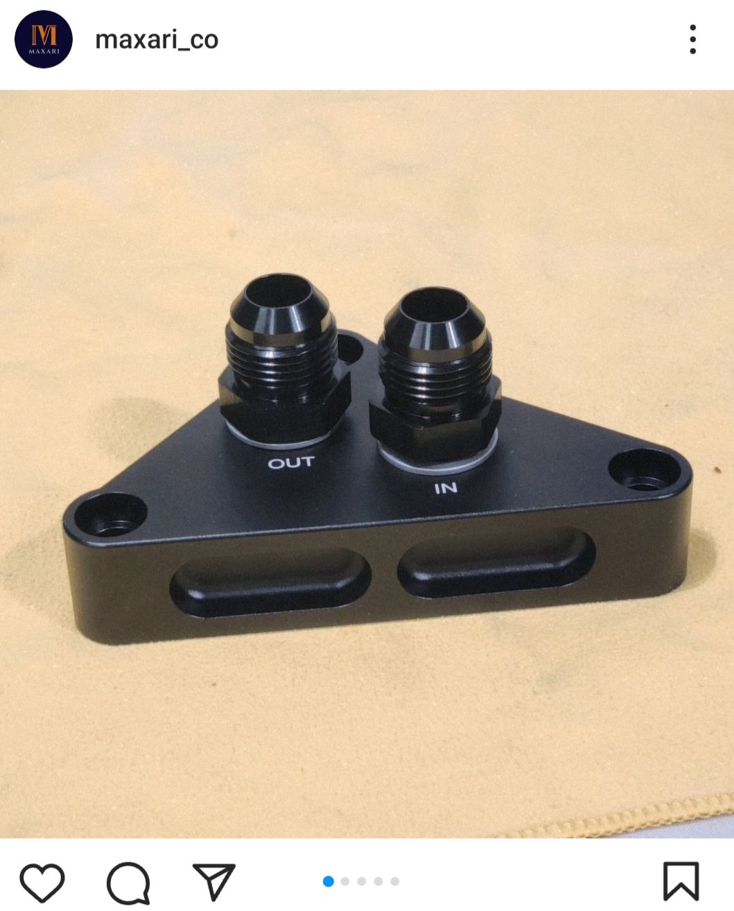

Convert it to a spin-on type and relocate the oil filter housing up top somewhere for easy and clean oil change. I've seen 4runner and FJ guys have done it ( YT channel 'off-road hub' shows you how). If you want to eliminate the OEM oil filter housing all together and make room for a solid axle swap, Instagram user @maxari_co has and oil block-off plate adapter that allows you to run lines to a remote Oil filter housing

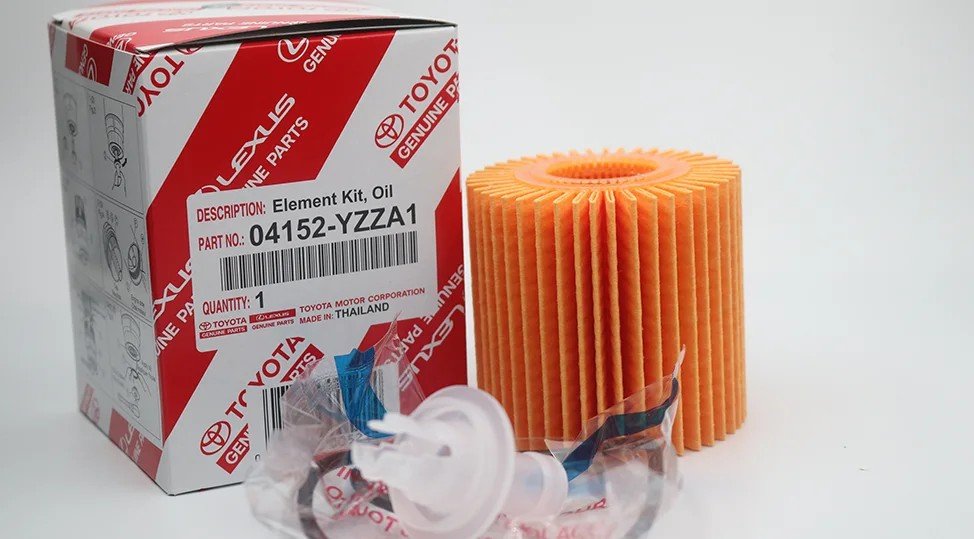

Use a OEM Toyota oil filter. They are less than $8 and come with new O-rings
