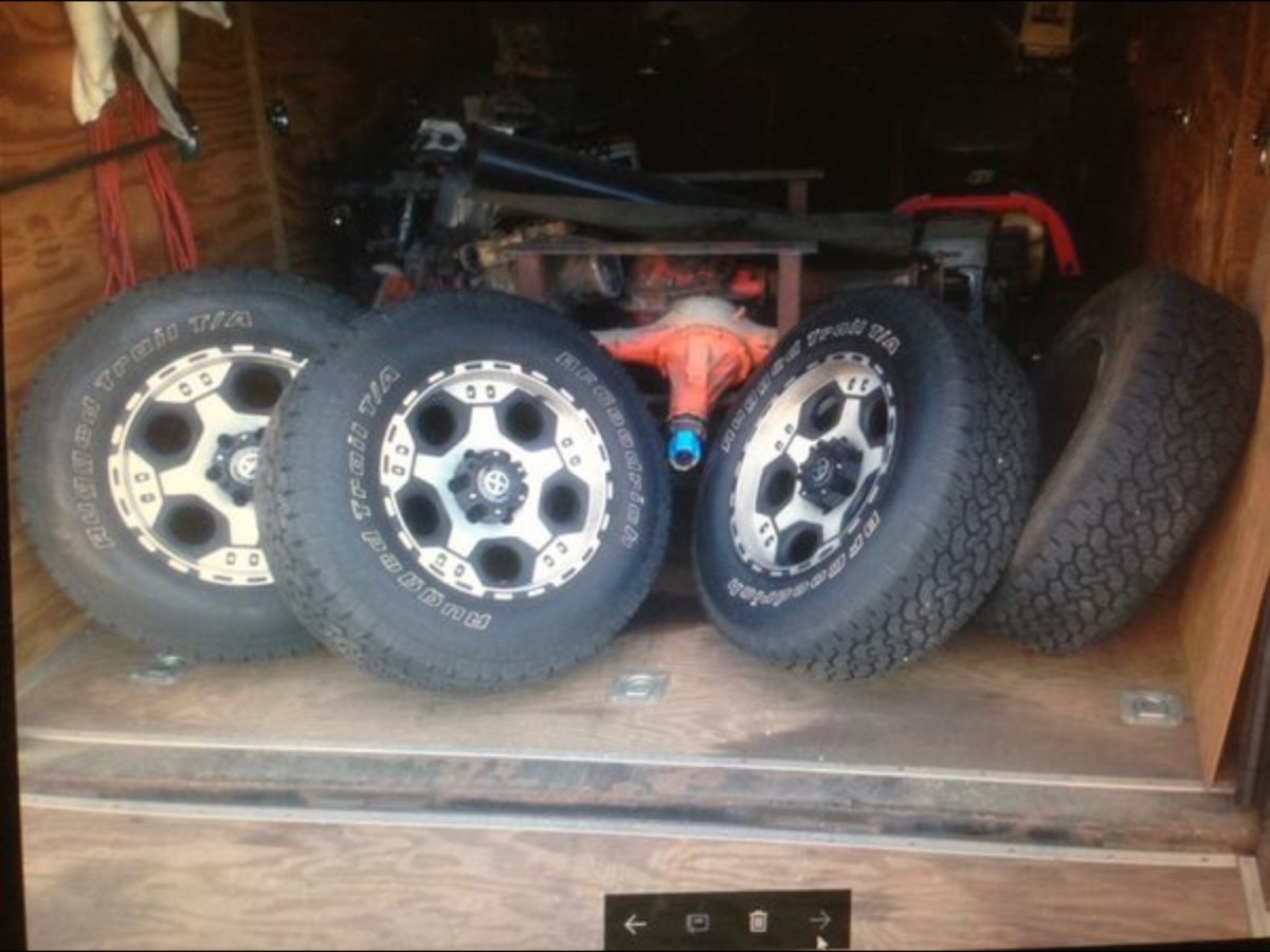

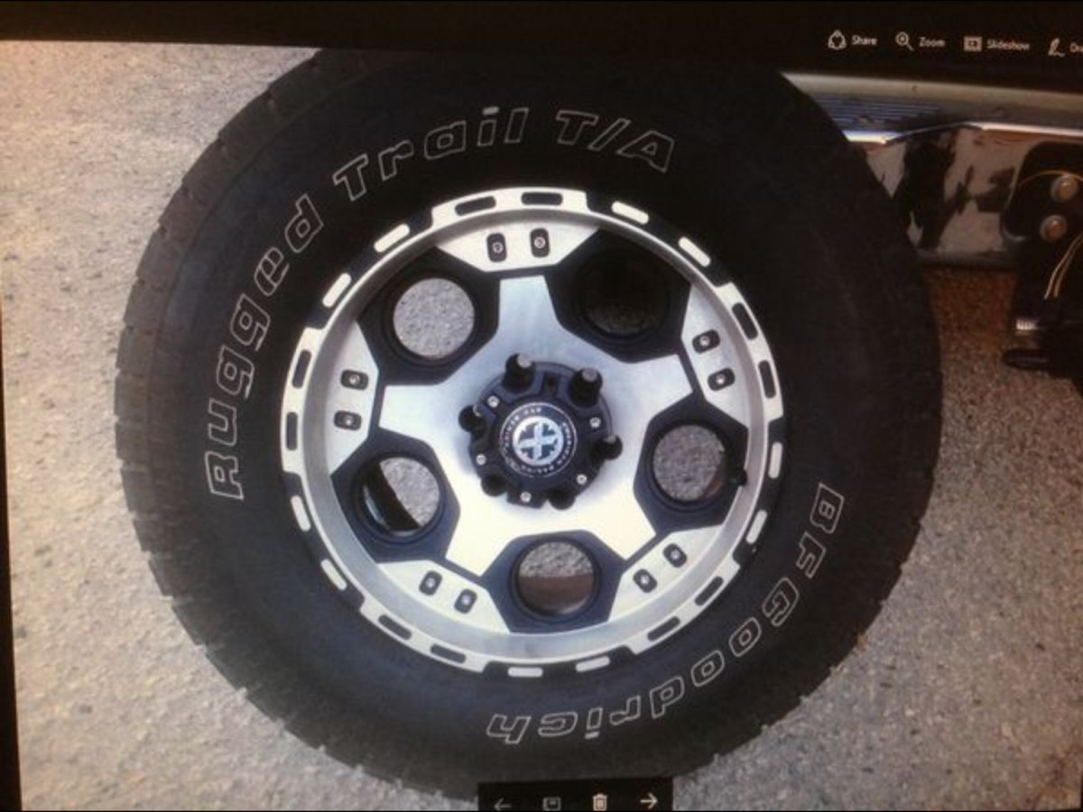

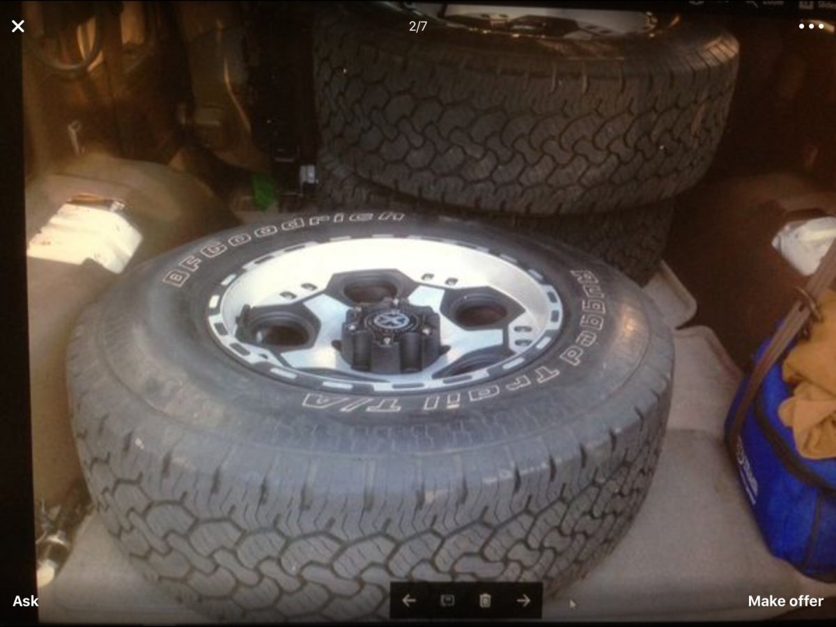

Any one know if the Chevy 6 lug pattern is the same as the Tacoma’s?
Found some wheels online that came off a Chevy that they said would Toyota’s as well. Thanks for your helpIMG_0032.jpgIMG_0033.jpgIMG_0034.jpg
I think I've read that factory Chevy wheels won't clear the Toyota brake calipers. Those being after market should be fine.. But @OR17TRD is are wheel expert...
The 6 lug pattern should fit fine but you’ll have to get the correct lugs. (Chevy and Toyota are different sizes).
Also, I can’t speak as to the rim size and tires without specifics in size.
I like the rims and the tires have somewhat decent tread left. Worst case scenario: buy them for a good price, resell them for what you got in them or more if they don’t line up.
Thanks guys I contacted the seller about off set and just waiting for a reply. The current wheels on the rims are lt265/70/17
Same size that I am currently running.
