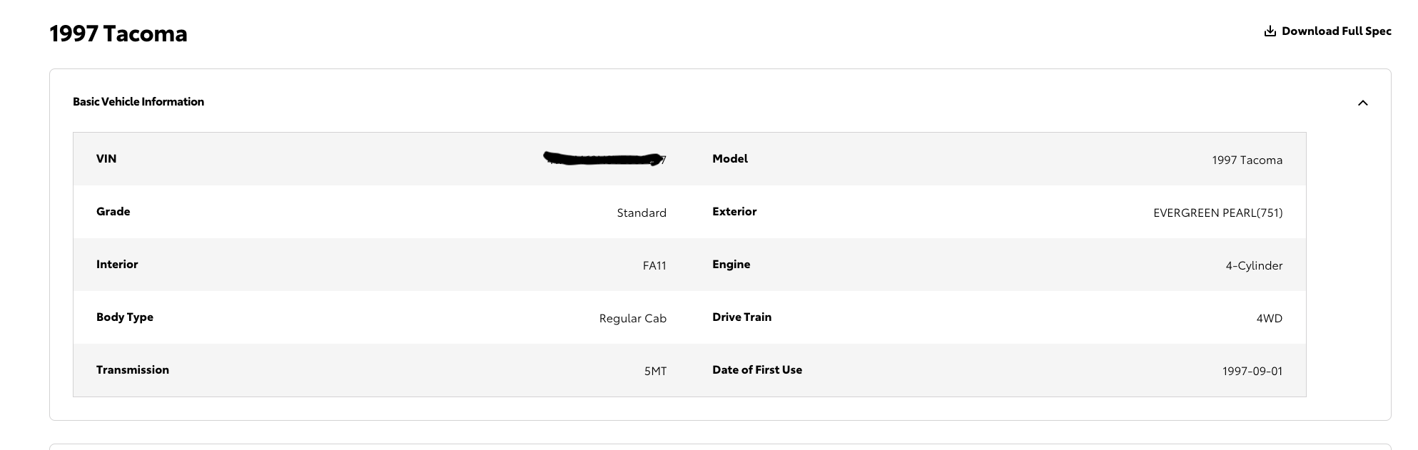

I found this source with twenty seconds of searching online:
There are literally hundreds of other sources as well including official and unofficial ones.
Incredulity is not evidence.
Sure, if looking for 2wd pickups, they had different gear ratios than 4wd's, but these are 4wds here.

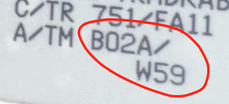

My truck is 4 wheel drive and came that way from the factory along with a 3.58 gear ratio.
If there is something I don't understand then let me know; but every axle decoding chart I have seen explicitly states that B02A corresponds to 3.58 and I have yet to read anything which says the contrary.

Its odd. All the ones I've seen here in new england had 4.10 gears. I've spoke with a friend of mine late this afternoon, and from what he's experienced, and found out, the 97 taco was offered with a bunch of different ratios, mostly on their 2.7 2wd trucks. Some 4wd trucks got 3.58 gears, but he hasn't seen any here yet either. Could be the part of the country these trucks were sold.
I share your surprise. The truck came with 225/75R/15 tires and 15" wheels which is quite large for a 3.58 ratio.
