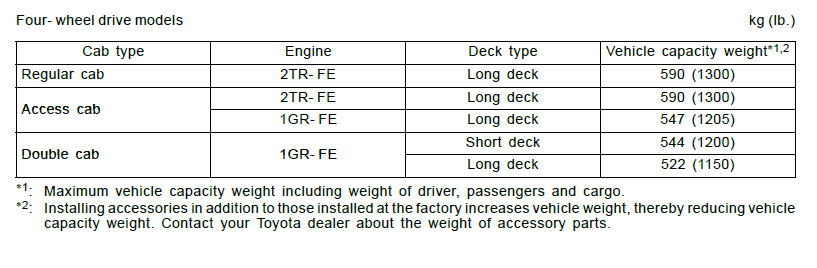

Referring to pg 394 of the Owner's Manual for the 2006 Gen2 this snippet. Specific attention to Note 2
Aftermarket wheels and non-stock size tires are considered accessories. Unfortunately, I was not able to find the GVWR in the Owner's Manual. That is probably on a placard on the Driver's door jamb

The weight from the heavier tires will reduce the cargo capacity.
Example: My '06 with me and a full tank tip the scales just shy of 4500 lbs. The cargo capacity of my truck is 1205 lbs (or 1/2 ton). So, the GVWR of my truck is around 5700 lbs. If I install heavier tires, say 200 lbs (heavier than stock), the empty truck with me and a full tank will be about 4700 lbs. Cargo capacity will be reduced by the 200 lbs, but the GVWR remains at 5700 lb.

There are a few numbers that are important to safe loading and towing within limits of the truck:
GVWR (Gross Vehicle Weight Rating) = Maximum weight of the truck and cargo with a full fuel tank and 150 lb driver.
TW (Tare Weight) = Weight of the truck with full fuel tank and 150 lb driver. No Cargo.
CC (Cargo Capacity) = Difference between GVWR and TW; GVWR-TW = CC
Anything added to the truck beyond the full fuel tank and 150 lb driver is considered as Cargo. For instance: remove stock bumper (assume 100 lbs) install aftermarket bumper/winch combo (assume 250 lbs), TW increases by 150 lbs, CC reduces by 150 lbs, GVWR remains static. A 300 lb driver hops in, then TW increase and CC decreases by 150 lbs.
