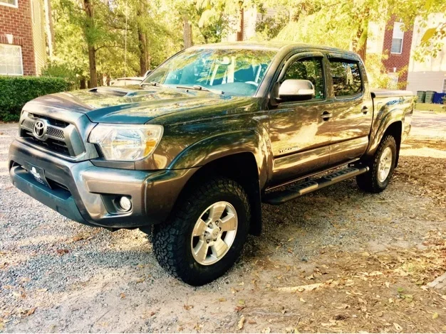

Hey guys, I put my 2.5 (front) and 1.5 (back) lift on this weekend. We dropped the tuck back down and now the traction control lights/ABS light stays on the whole time. I went and got new 265/70/17 tires then got the truck aligned. Lights still on. The tech at the shop said they didn't have the means to reset the steering angle sensor. I'm worried I popped an abs break line. 2012 prerunner front wheel drive. Any help or tips are much appreciated. I love my truck and I don't want to ruin anything. Thanks. ImageUploadedByTaco Forum1477868983.632245.jpg
Wouldn't there be a tell tale leak at the point of breakage? I am going for the same lift as you soon, about to 2" in front and 1 1/2" in the back. Anxious to see what you found...
No leaks. Must have just stretched the abs line. Truck still drives normal. The lights are annoying though.
Make sure you do your research and disconnect the abs line before lifting to avoid this.
