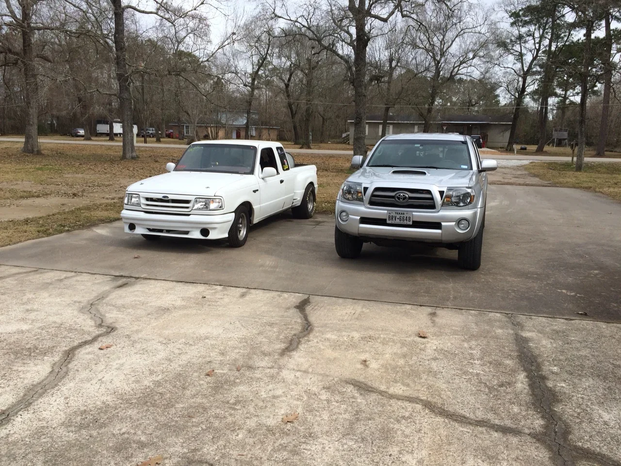

Truck size

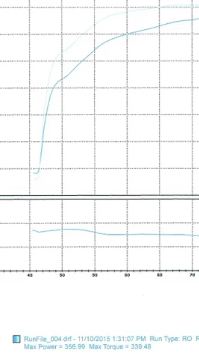

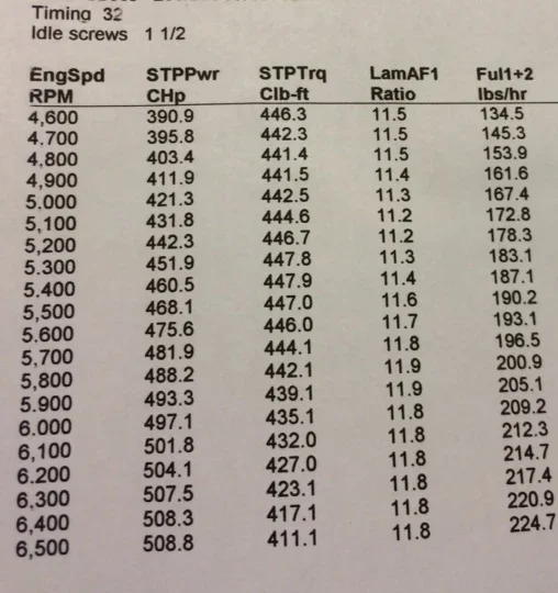

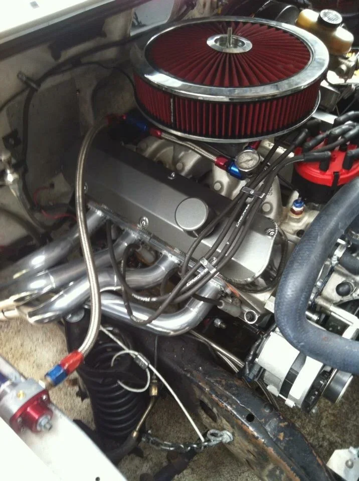

The ranger has a 347, c4 transmission, 4:30 gear. It’s a race truck only.
Yeah they built the converter and it should be 4,000 stall and it’s lucky to get to 2600 before it pushes the truck. I think it’s a high 10 second truck if I had a trans brake and a 4,000 stall. Still not bad for motor and 3260 pounds
