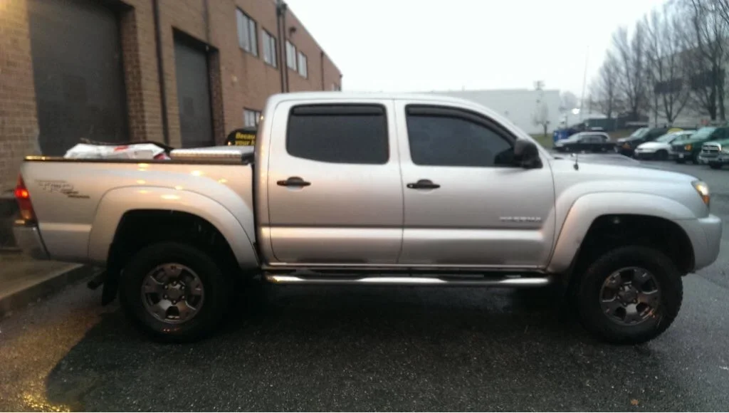

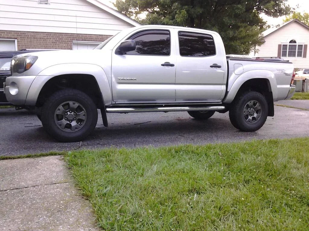

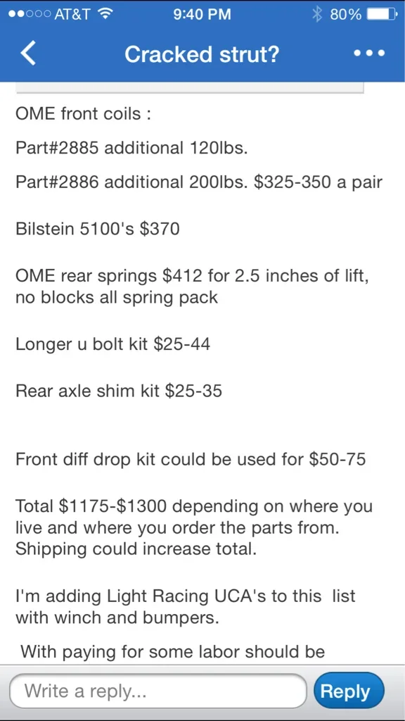

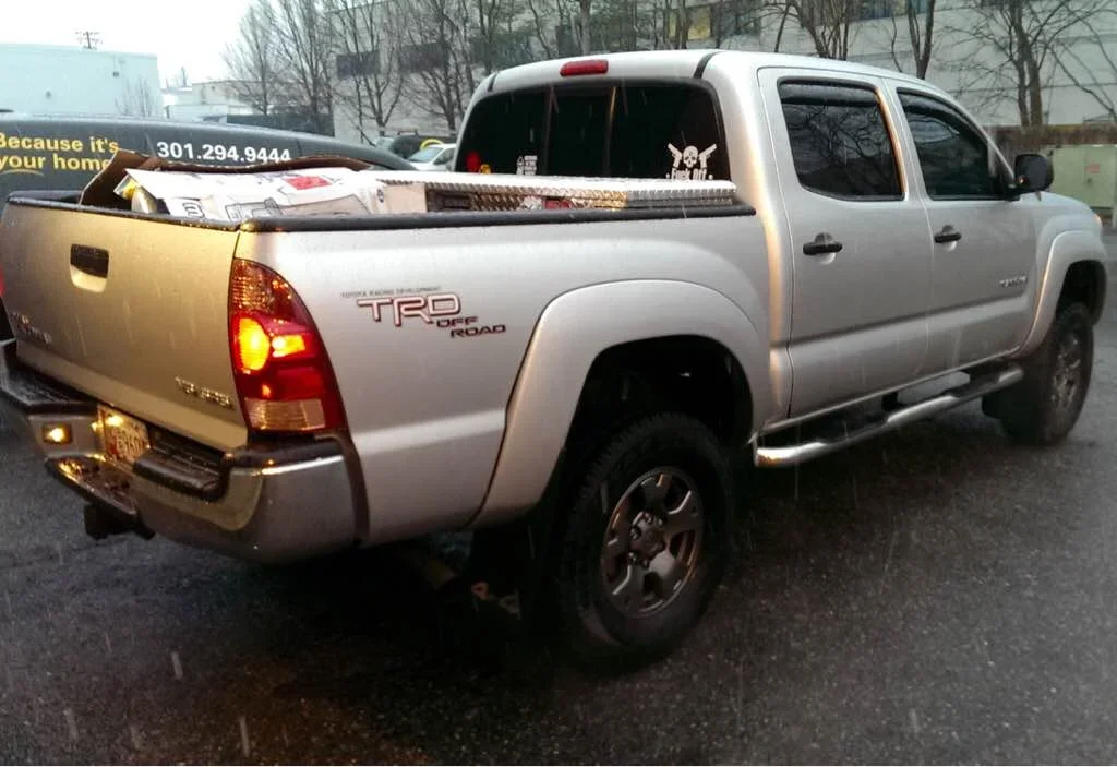

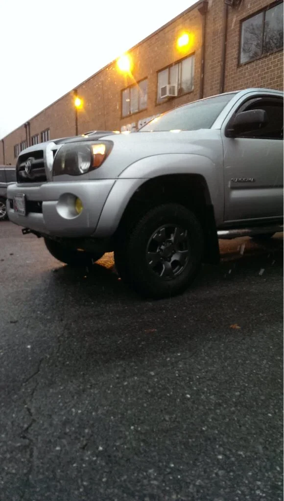

The answer to your question is "no". Usually when you go to do a lift on a Toyota truck people usually buy a lift kit in a package. Some of the more expensive lift kits come with extended upper control arms. If you tried to just install the aftermarket uppers, they prolly wouldn't fit cuz in order to make it work you'll need a extended travel shock/strut, and a set of lifted coil springs to complete your front end lift. What i did on my 2006 Toyota Tacoma was I bought ToyTec 3"spacers for the front (after you put the lift on the front of your truck, you MUST get a front end alignment done immediately). Also, if you dont want a front end vibration, you'll also need to buy front differential drop kit. After that, I bought a set of "Old Man EMU" rear lifted leaf springs, which lift the rear about 2 1/2" and the front spacers gave me about 3" of lift. Also, no one ever told me this so i had to figure this out on my own, the slightly older Taco's once lifted have a problem with the drivers side of the truck sits lower by about a half inch than the passenger side. So they sell a kit that corrects this problem. Anyhoo, here's a couple shots of what my truck looks like after my lift install.ImageUploadedByTaco Forum1423092042.311934.jpg
