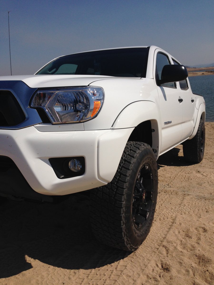

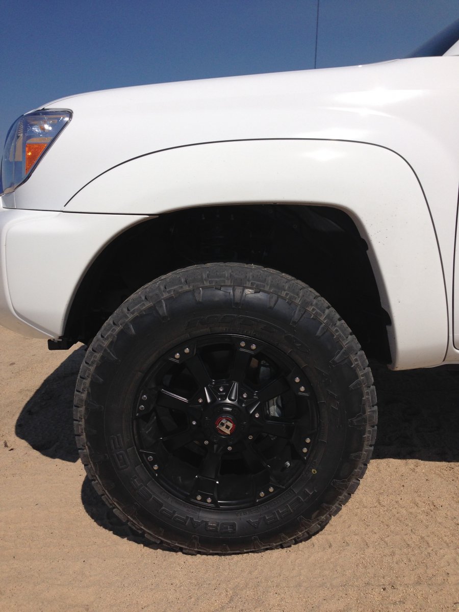

New to the forum, and Tacomas. Just bought a 2014 TRD Offroad. It has an Old Man Emu kit underneath, so the height is where I want it, but I'm looking for wheels to give it a little wider stance, and tires that I can rely on in the mountains.

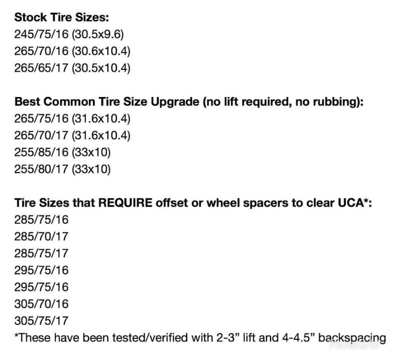

2.5-3” lift if you want a wider stance I’d get -6 offset and put 285/75/16 or 285/70/17 tires on. I wouldn’t go 18”. To much rim not enough rubber for me.
265/ 60 -18 (30.5 x 10.4)
265/ 65 -18 (31.6 x 10.4)
285/ 65 -18 (32.6 x 11.2)
