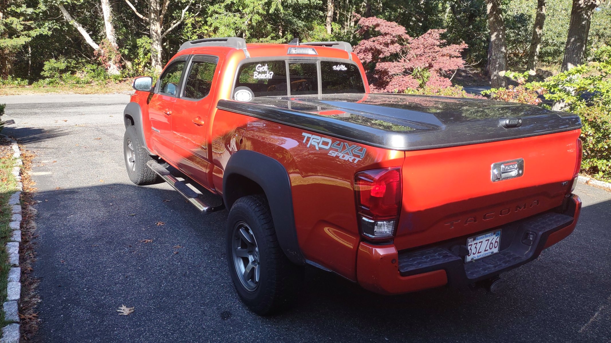

Don't use a -12 offset,4.5 backspace IMG_20231008_100414004.jpg I ended up putting 1.25 spacers to push rims out a little, maybe 0 with like 4.5 back space. They are 17 x9 wide ,And they rub full turn but I'm going to put 285/65\17 on it they are 1"or so wider but about and inch shorter .

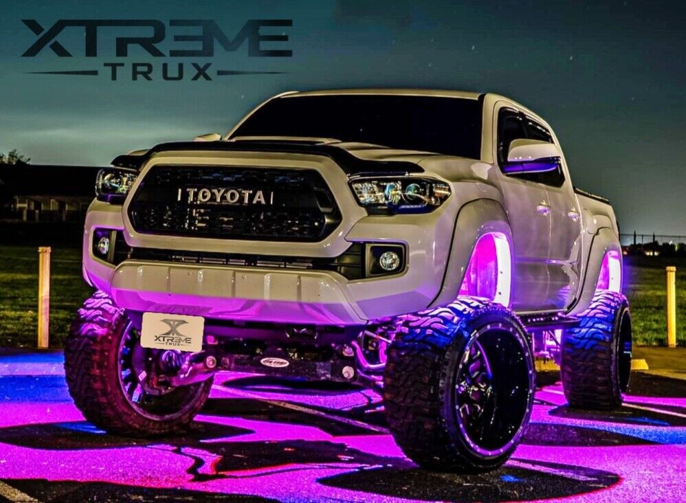

1697165184685.pngebay is where i got the flares . i had to get textured cuz smooth were out of stock! during covid but im going to paint ths orange! Super easy to install too! Little over two hrs by myself.
