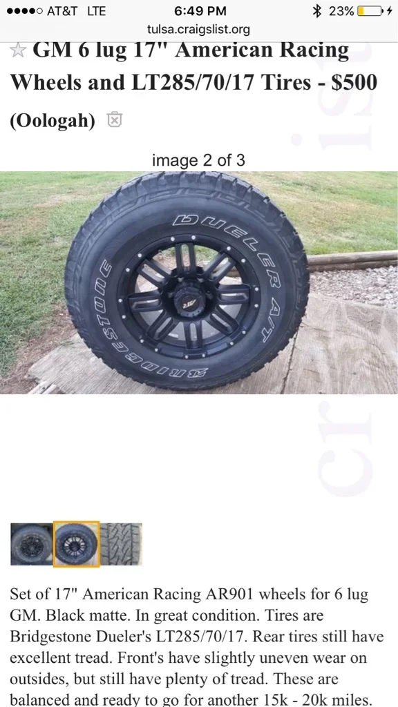

evan.thomas20 Member Sep 14, 2016 #3 whippersnapper02 said: The center bore might be different. Click to expand... How could I tell??
whippersnapper02 Negative Nancy Sep 14, 2016 #4 evan.thomas20 said: How could I tell?? Click to expand... American Racing's site should hve specs. Tire rack may have specs for the Taco. Now that I remember, my buddy used wheels for a GM on his Tacoma. He had to get the bore machined to fit.

evan.thomas20 Member Sep 14, 2016 #5 whippersnapper02 said: American Racing's site should hve specs. Tire rack may have specs for the Taco. Now that I remember, my buddy used wheels for a GM on his Tacoma. He had to get the bore machined to fit. Click to expand... Thank you so much it's amazing of how helpful y'all are on this site.
