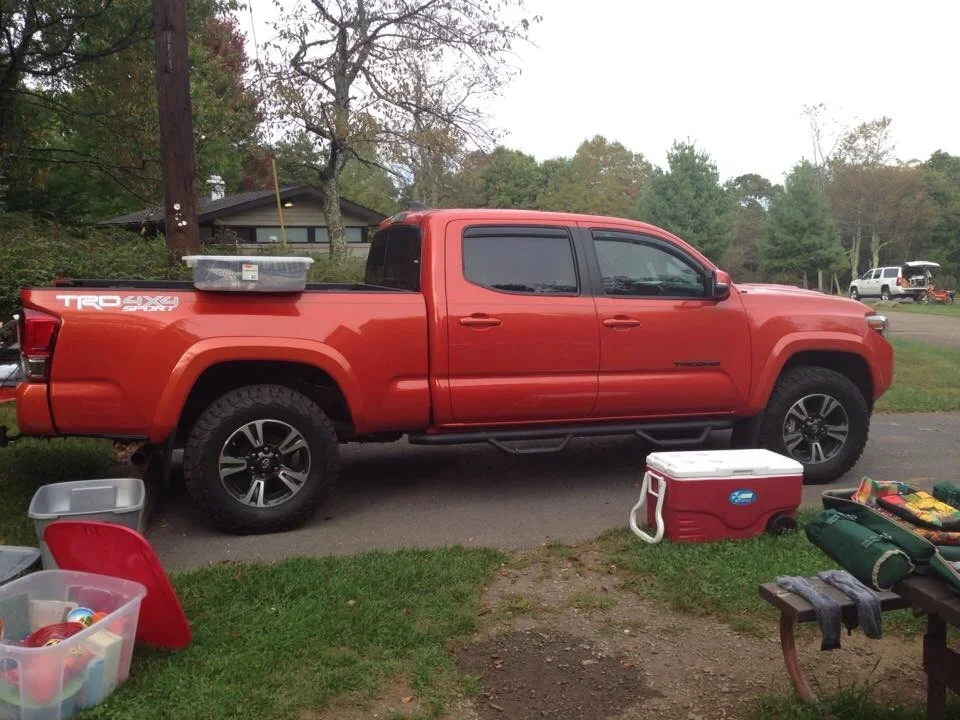

Roughly 11k. I only run 89 or higher. I noticed it when I bought my truck this time last year (new 2017 like yours) but it went away. IMG_0203.jpg

Nice truck. I am hoping mine straightens up as I love the truck. I see a lot of short beds in the OR but have not seen many long beds in that color.
2 of us on here will argue over who has the real unicorn of tacomas but I went to the dealership and told them: has to have a sunroof, 4x4, crew cab, hood scoop, long bed, and be that orange color....I REALLY wanted the matte grey that the pro comes in but they don't make the pro in a long bed:/ I had to wait over a month for it to arrive. Before, I had the same truck but an 06 in that bright blue with a lift and no sunroof.

I found that there were only 5 trucks like mine (TRD OR, ext. cab, 4x4, in the Inferno) in the southeast. Only one in NC and I was able to get it. Had a couple of dealers that had it, but was a short bed however did have the sunroof etc. Personally, I do not care either way on the sunroof, but really wanted the long bed. Not going to say it is a unicorn truck, but probably up there around the albino deer level as it was difficult to find and I have not seen another TRD OR longbed on the road around here...all have been shortbeds.
I had a 2010 sport in a longbed before and really enjoyed it. Really wanted the OR this time and so far really enjoying it.

I like my 2017 DCLB OR. I had 3 dealers looking for over 2 months and was told multiple times by multiple sales guys. “You’re looking for a unicorn man!” Lol. That’s why I named her Tacorna.

Yeah, my wife can confirm that I'd someone tells me that I cannot...it is a good bet that I will. I had about 3 different dealers tell me that there is not one like I want or they could order one from Toyota, however the same dealer that we bought an FJ from years ago found this one. Great little truck and very sharp looking in the Inferno. I get compliments on it all the time, but definitely cuts down on any mischief or speeding as everyone knows who it is and it does not blend into traffic well. :)
