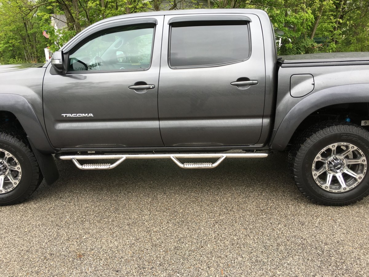

This is the 2013 that I just traded in for the 2018 inferno red so I would like this type out of look I bought the 13 used IMG_1544044015.741159.jpgso I have no clue what type of lift was on it
