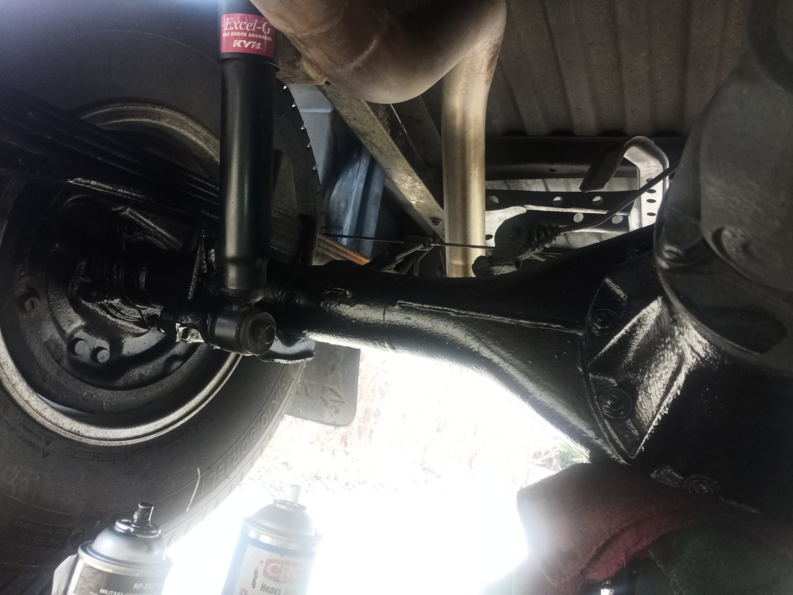

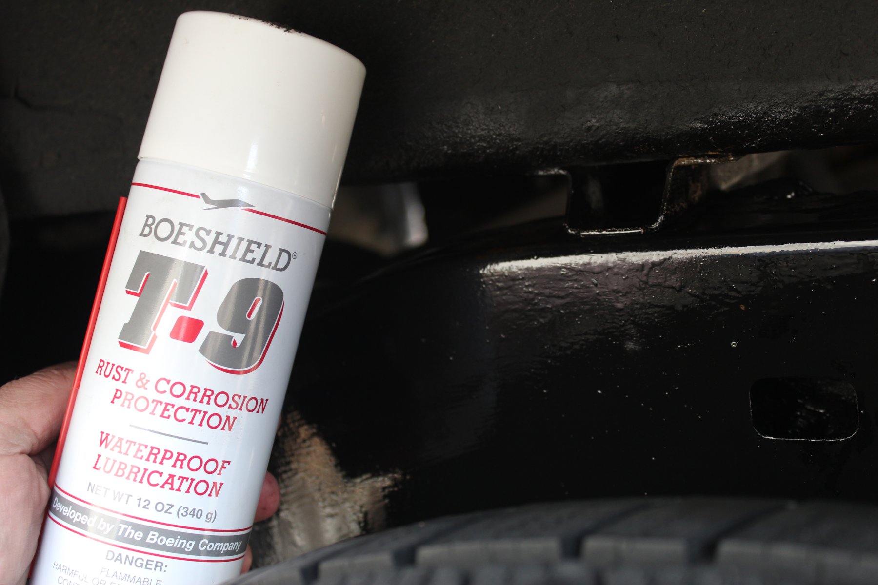

3-17-23

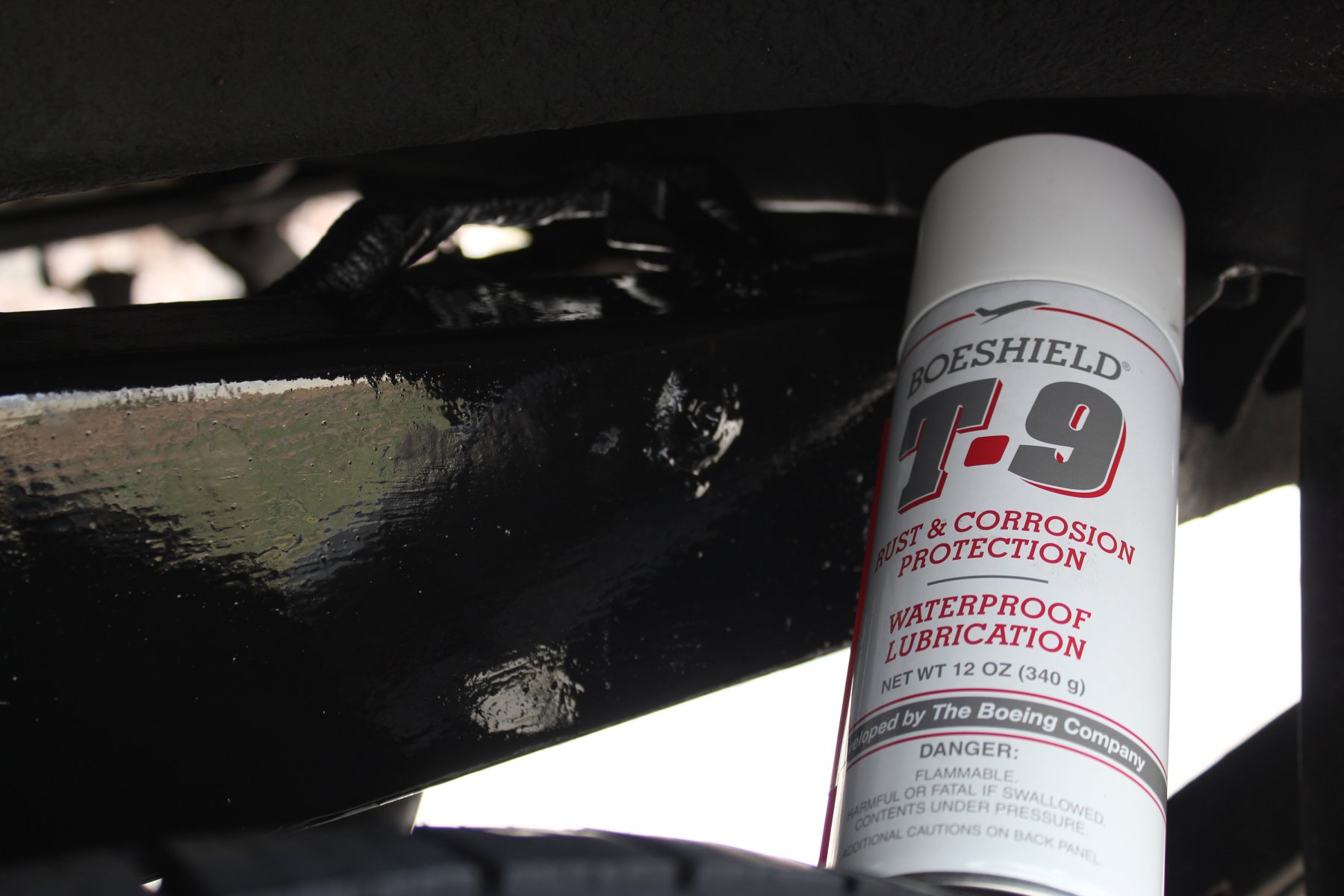

experimenting with the boeShield T-9 product

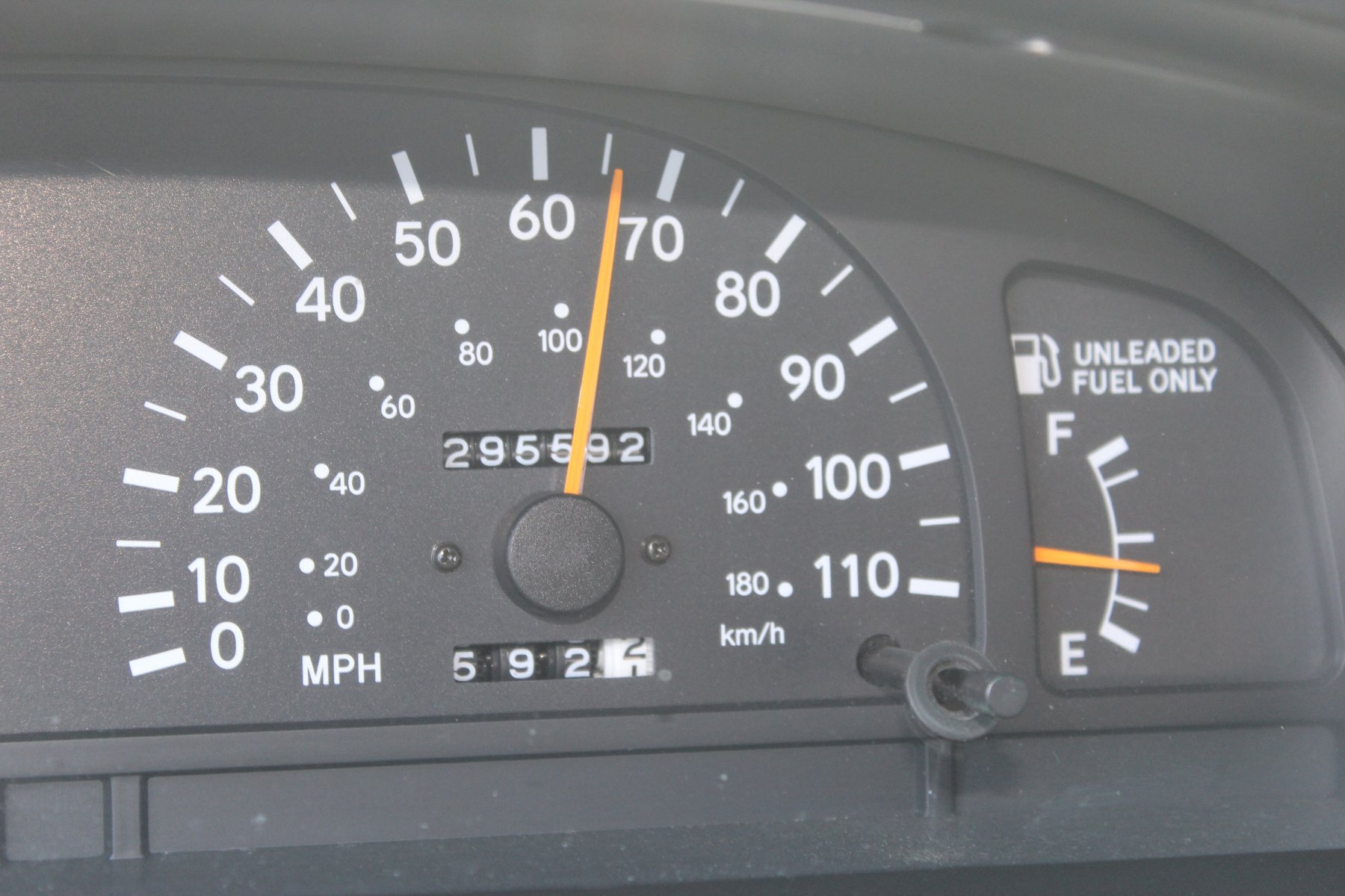

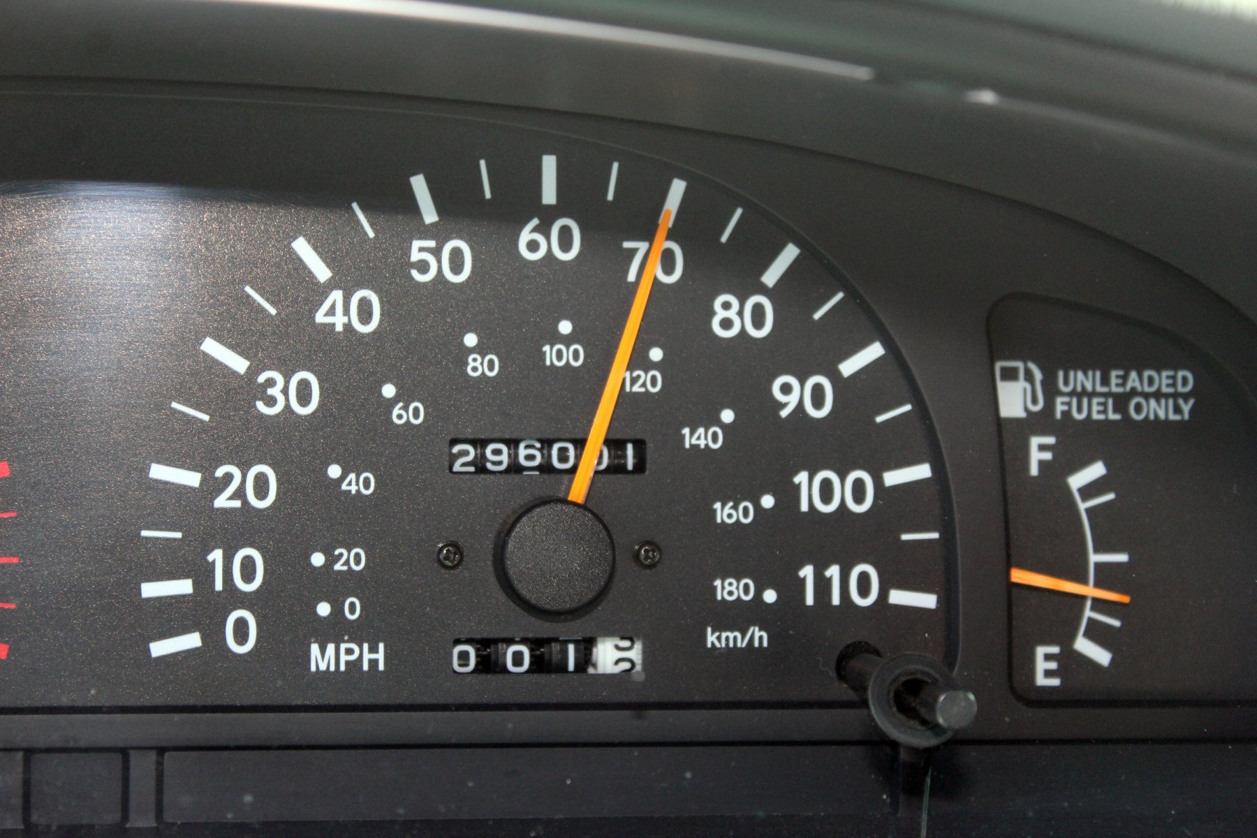

Manufacturer recommended services at 300,000 Miles​
DRAIN & REFILL​
  • Drive Axle Assembly
  • Engine Oil
  • Transfer Case Fluid
  • Transmission Fluid
DRAIN, FLUSH & REFILL​
  • Engine Coolant System
INSPECT​
  • Accessory Drive Belt
  • Axle Shaft Oil Seal
  • Brake System
  • CV Joint Boot
  • Differential Fluid Level
  • Engine Air Filter Element
  • Exhaust System
  • Fuel Evaporative Canister
  • Fuel Line
  • Fuel Tank
  • Steering Gear Box Assembly
  • Steering Linkage
  • Suspension Ball Joint
  • Transfer Case Fluid Level
  • Valve Lash
  • Wheel Bearing
LUBRICATE​
  • Driveshaft U-Joint
REPLACE​
  • Engine Oil Filter
  • Spark Plugs
  • Timing Belt
ROTATE​
  • Tires
TORQUE​
  • Body Fasteners
  • Frame Fasteners

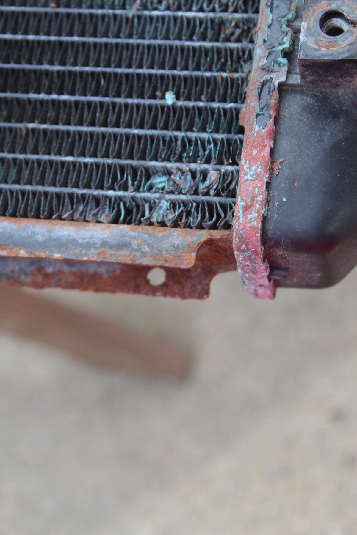

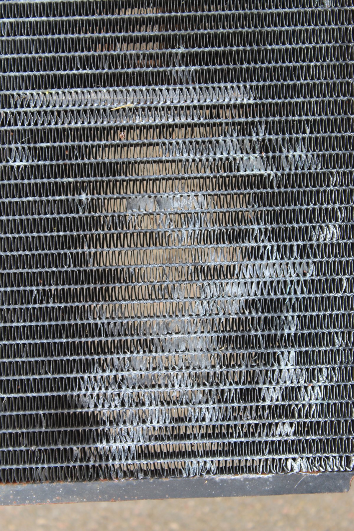

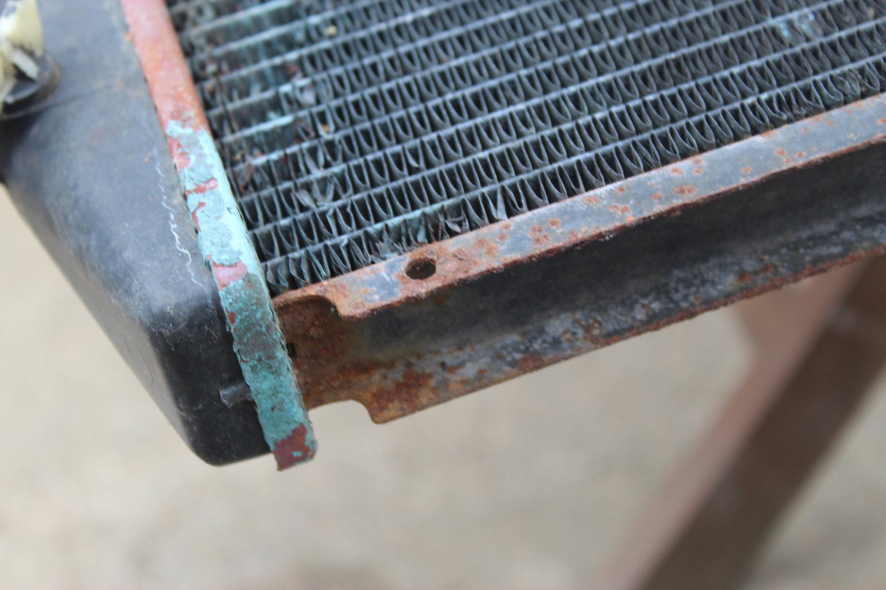

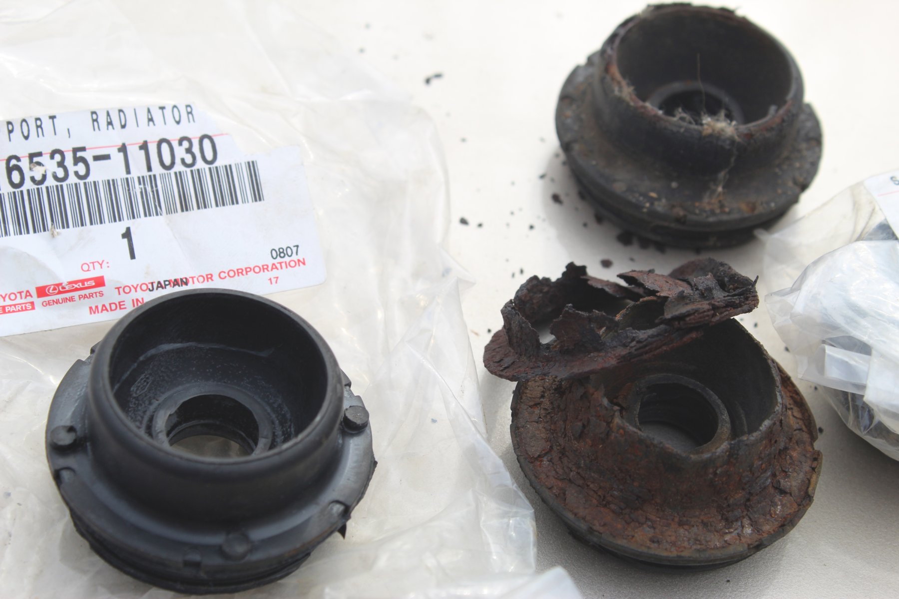

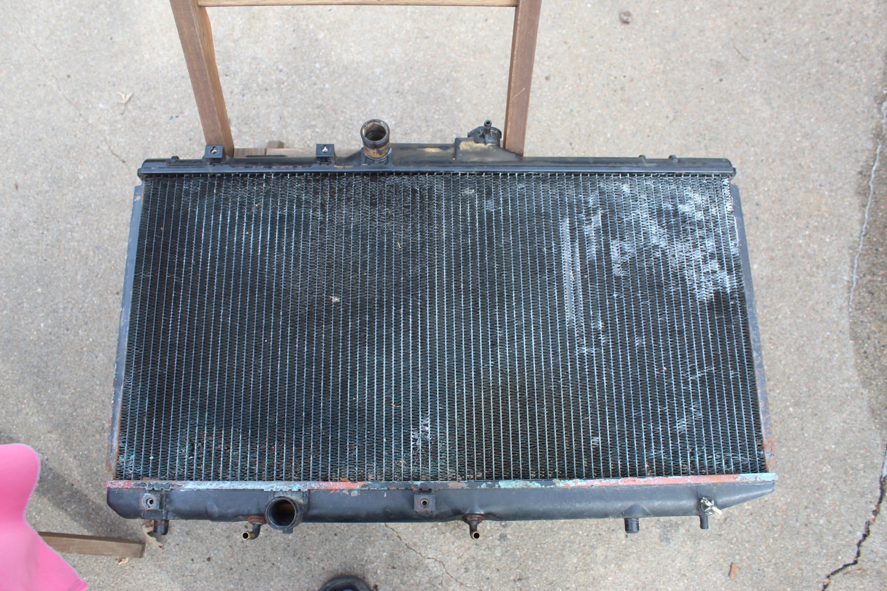

attempting to remove and swap radiator on that old Corolla 2day
1675088366236-png.35303
a bit of snow out 2day, gone in the afternoon when the sun come on out
27+ year old radiator finally removed on the old Gen7 Corolla
