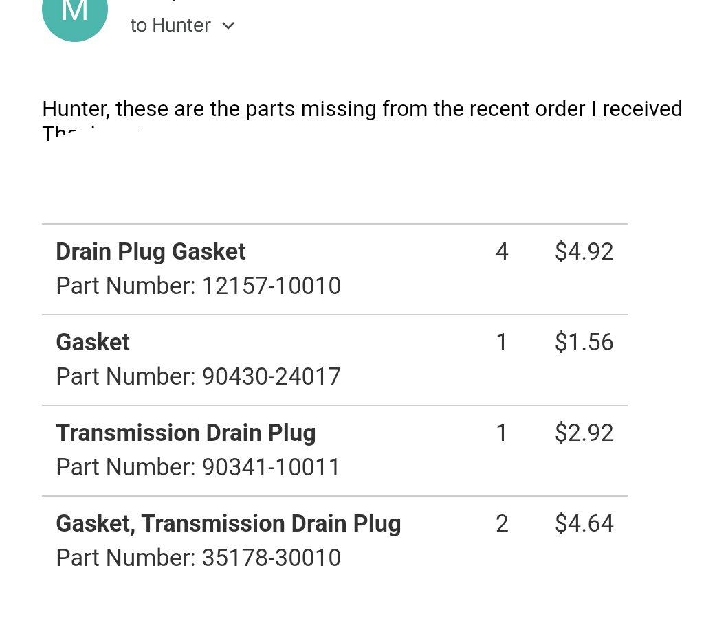

Order No
T15010000320173

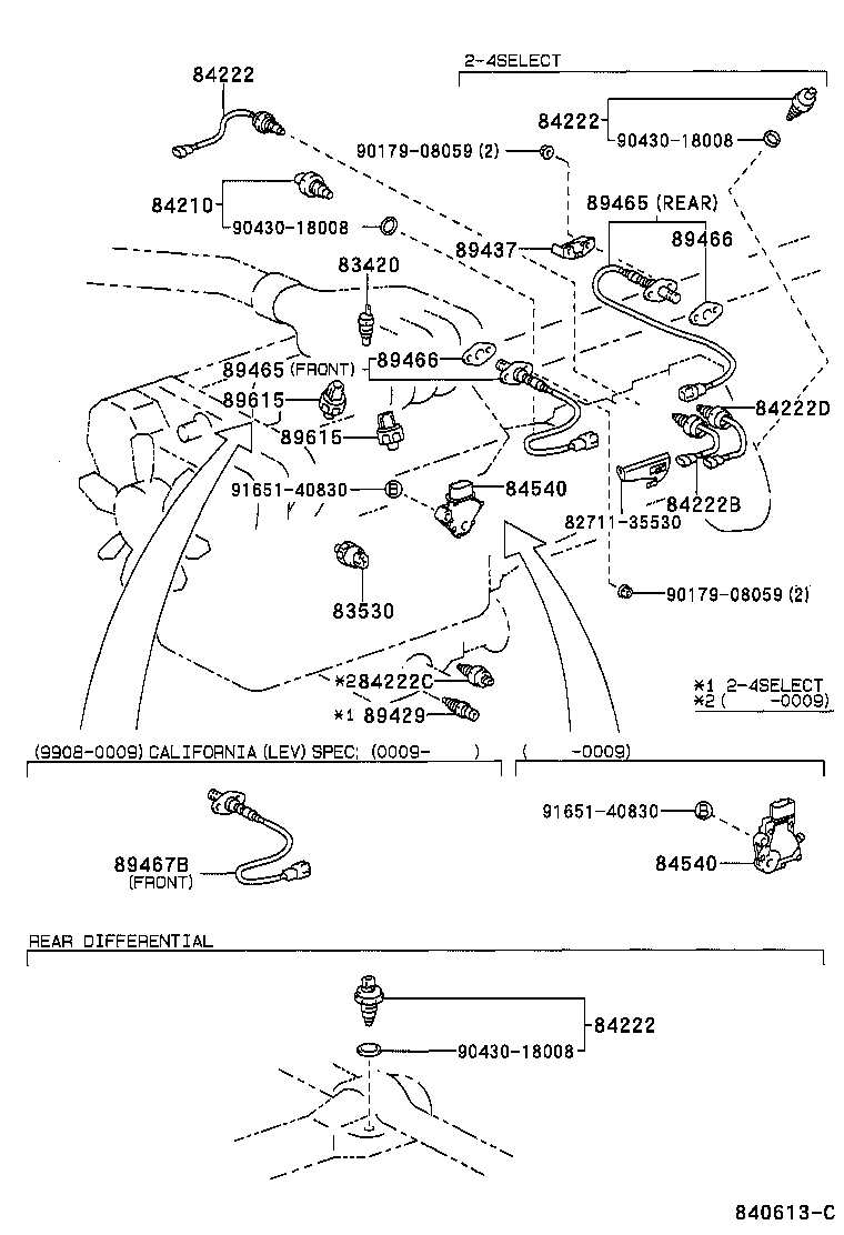

halfway done with inspection, overwhelmed when found the loosey goosey downstream 02 wiring

downstream 02 wire dangling loosey goosey flopping in the wind

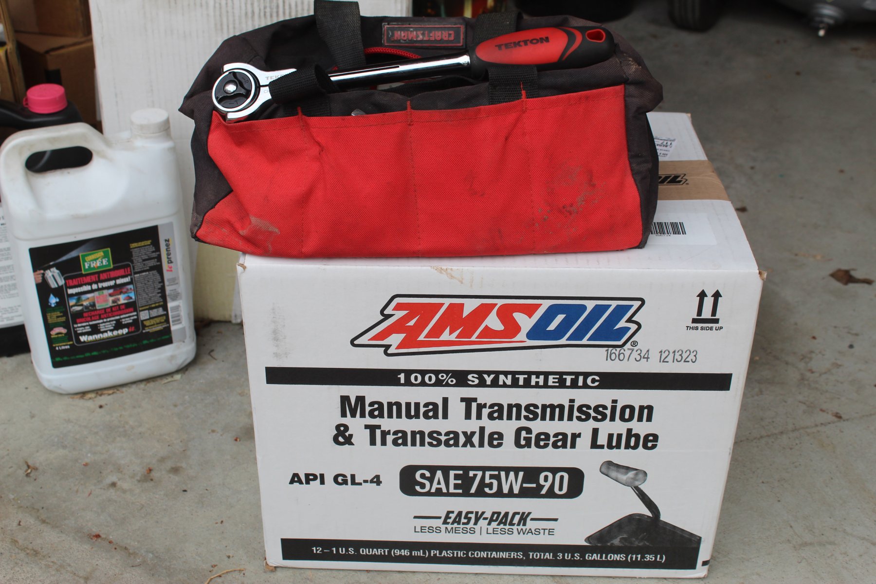

case of that AmSoil MT Gl-4 arrived yesterday
gotta change out that initial MT gear oil after 3k miles wheeled onit
