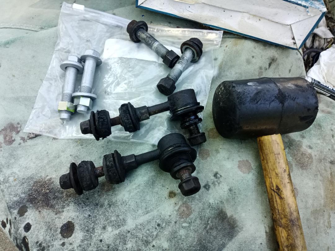

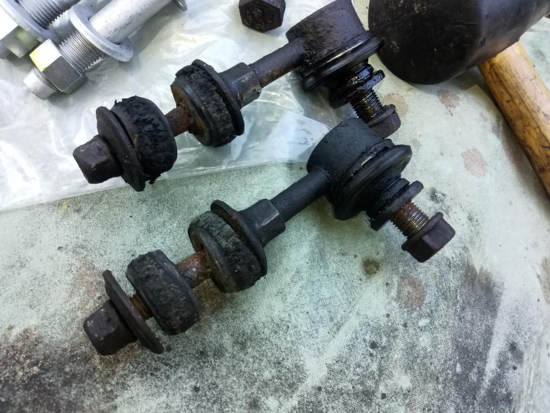

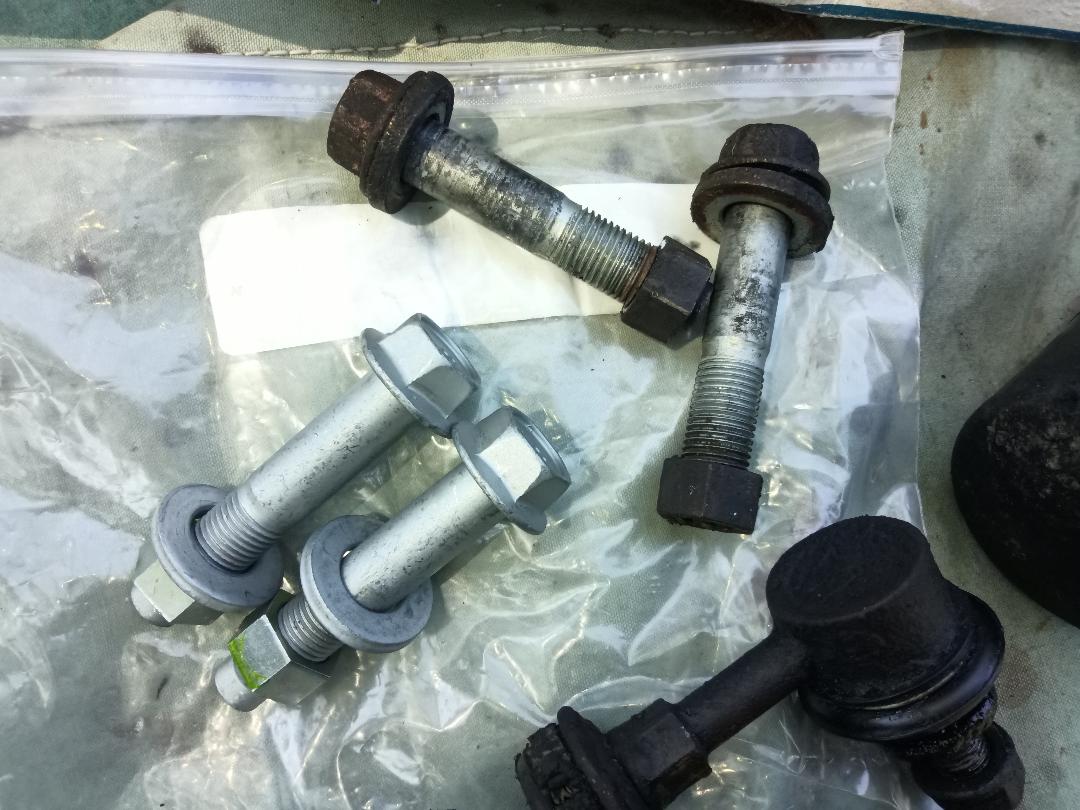

old vs new front shock bolts + old links

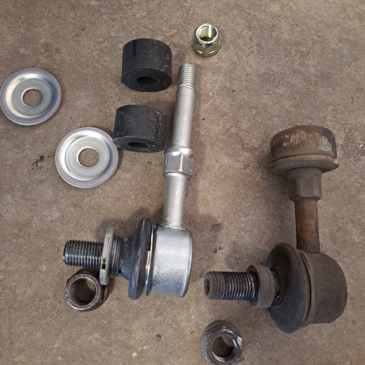

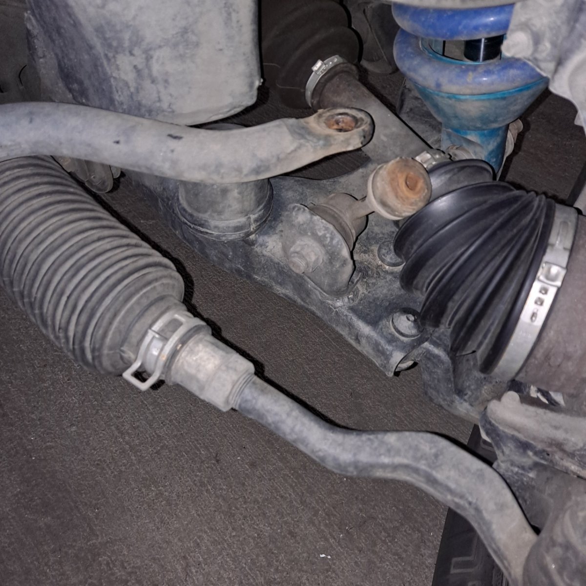

those stabilzer bar links can and do snap break as exampled by these from Denver on the +700k superCharged '97

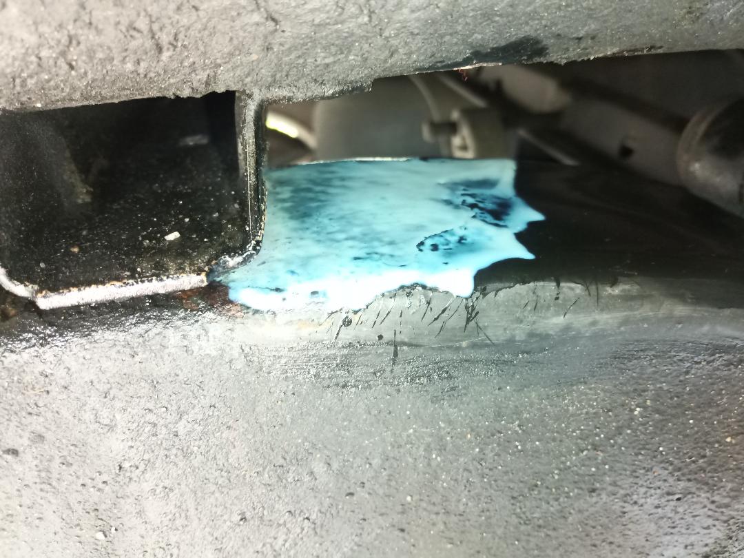

the paint in the shock tower cavities ought to be cured enough to get the new quikStruts installed today

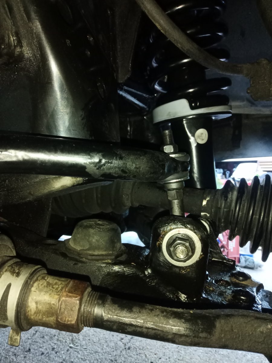

that was definitely an ordeal getting those quickStruts on yesterday, worse when found the Monroe factory did not assembly the top part proper and had to compress the spring to orientate the mount insulator in the proper direction for it to slip in with ease
now my inner upper back shoulder area is all buggered up :( from trying hard to press the LCA down enough to wiggle the first attempted install on driver side before noticing and investigating the defect
looking at prior pics the lower washer on those MOOG stabilizer links may be installed improper :eek:

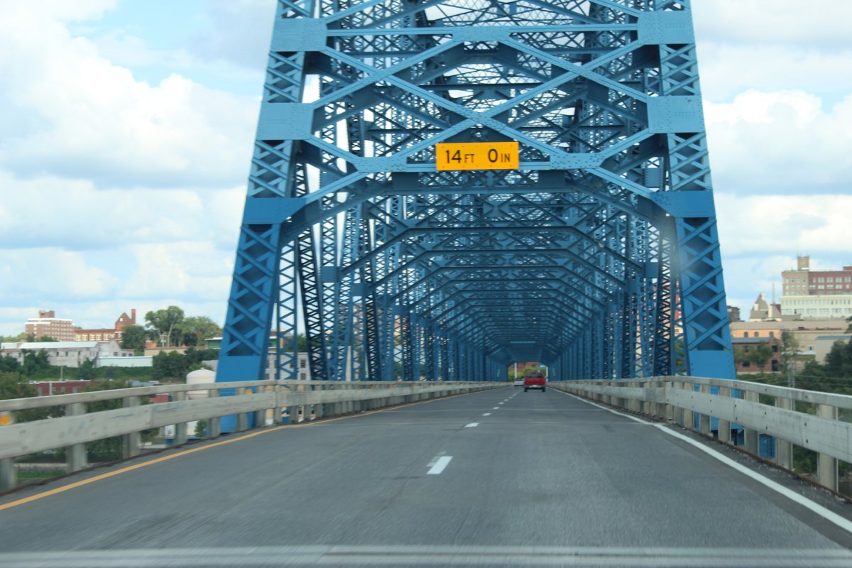

... will be a good test on these new quickStruts over that rough Quincy bridge on the Mississippi if its as rough as was the last time i wheeled onit
wheelin' the '97 on the 97 on 9-7
truckin' it thru Havana and Cuba :confused:
the bridge to Quincy must have been resurfaced because it wasn't nearly as harsh as i recall from many months ago
but that climb up from the river crossing was still broken as ever
